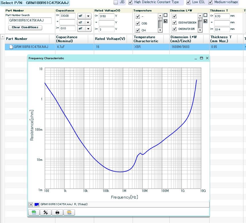

    The recommended input and output capacitors from the TPS65132B are from Murata and there you can get the information about the ESR characteristics.
    Murata is providing a very useful tool, SimSurfing where you can analyze the characteristics of many capacitors.
    As an example, this is the ESR vs. frequency curve for the input capacitor:
    You can find all recommended components from Murata in this tool and get the characteristic curves.

  • Hello Given,
    Customer may use capacitors from other vendors which match the recommendations in datasheet regarding effective capacitance and else (see capacitor selection section on D/S page 27). It is not necessary to have the same ESR vs frequency curve. In general, using a capacitor with a low ESR is recommended.

  • Hello Given,
    You can take the ESR value of the above ESR characterization curve as an indication. As an example the ESR should be in the range of 3 mOhm at 1 MHz.
