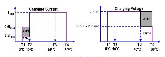

  • Hey Ben,
    At T1, all charging will stop, so assuming you calculated the values correctly, at -40C.
    At T2, according to the picture below (this is for the BQ25890), the charge current will go down to the 20%_FastCharge. Thiat is driving the device into Tcool region, which automatically disables termination.
    While you are between T2 and T3, the device will keep termination enabled (unless you disable it), which is at 64mA. So unless you drive the device into the Tcool region, your FastCharge may have to be a bit higher.
    Also, make sure the battery specs match what you need (-40C to 85C) in terms of charging region.
