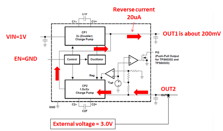

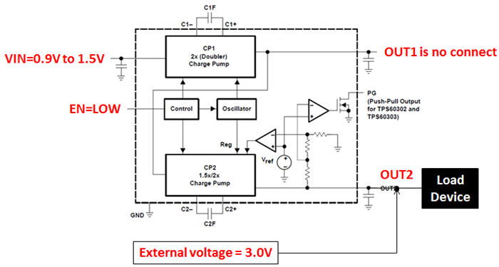

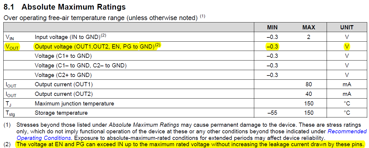

Hi Team,
Our customer would like to know about behavior when VOUT becomes higher than VIN and EN pin is LOW.
Customer's circuit is as follows.
They worry whether the reverse current occur and whether they can apply external voltage(3.0V) to VOUT2 pin when EN pin is LOW.
Could you please let us know if you have any concern?
