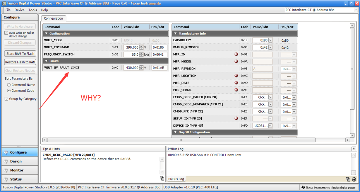

Why I cant increase IOUT_OC_FAULT_LIMIT (0x46) on the GUI

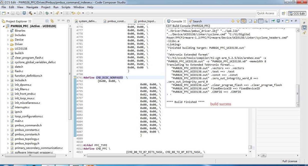

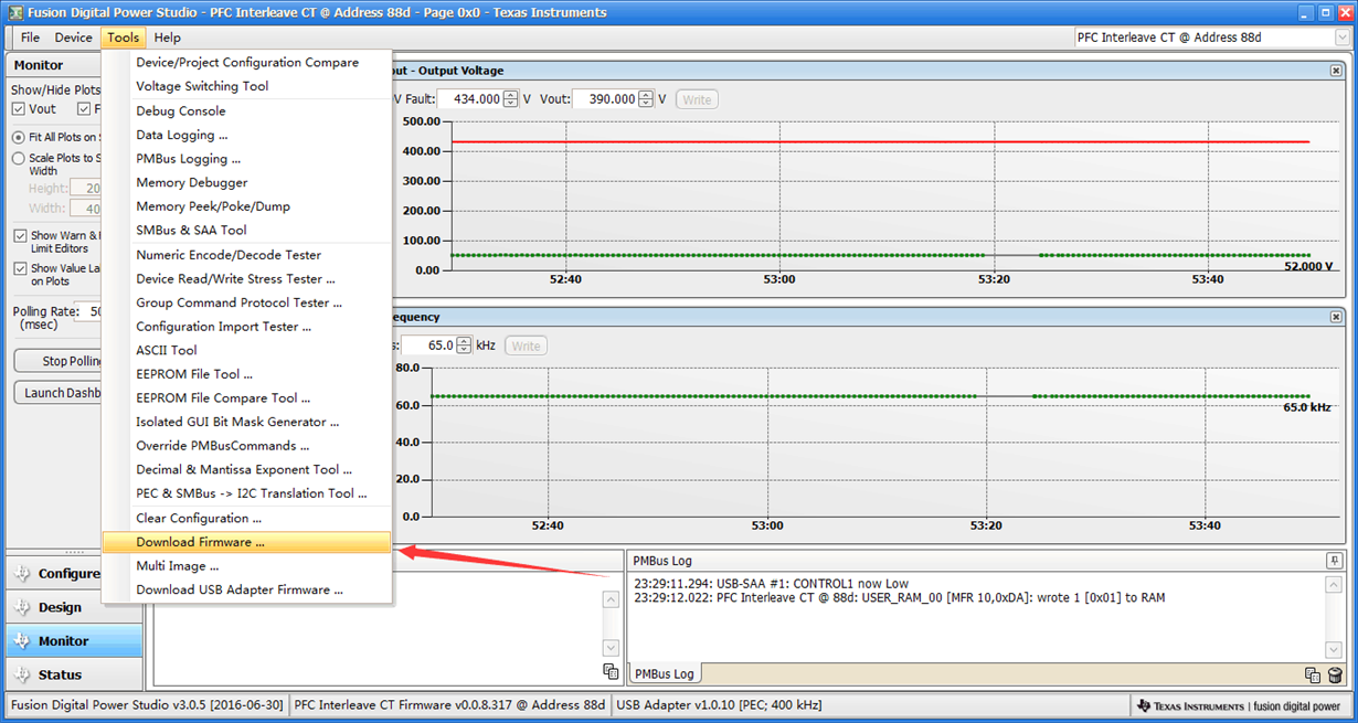

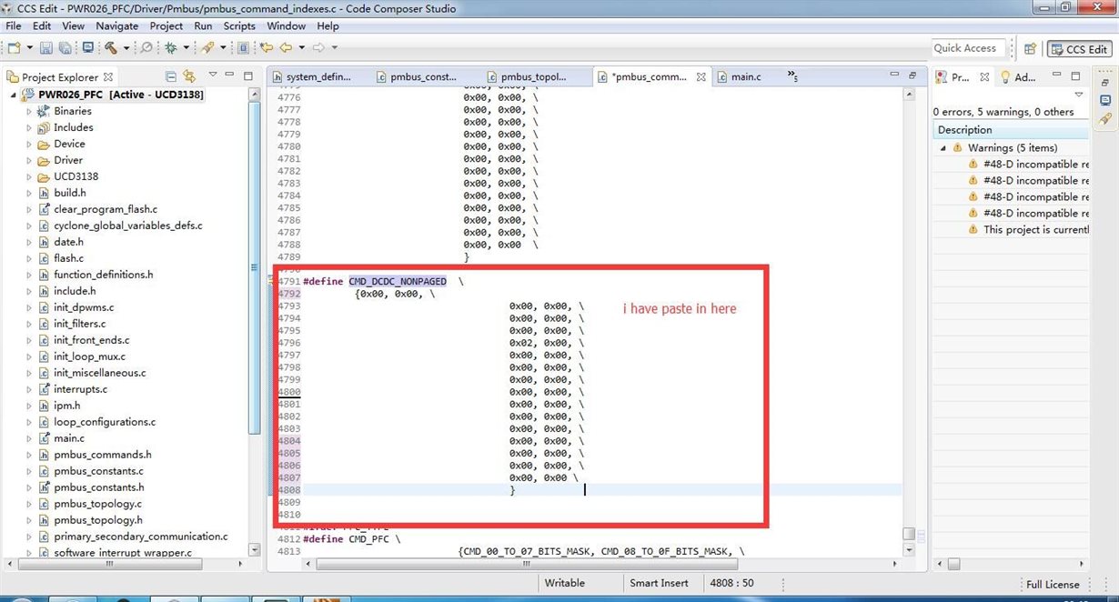

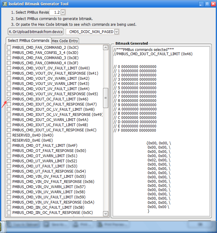

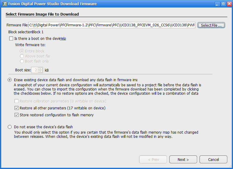

as the topic,  i  have tried  once more.  as follow,
