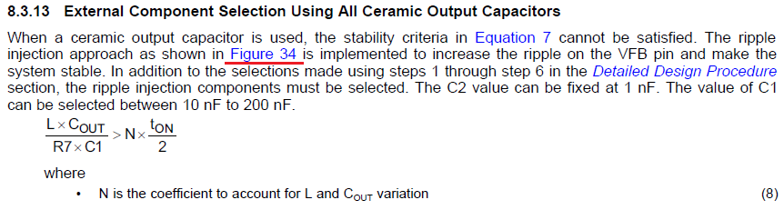

TPS53319 / 8.3.13 External Component Selection Using All Ceramic Output Capacitors
Guru 29720 points
Hi Team,
I believe the following "Figure 34" is typo and "Figure 45" is the correct.
There is no ripple injection components in Figure 34.
Could you modify it on next datasheet update?
