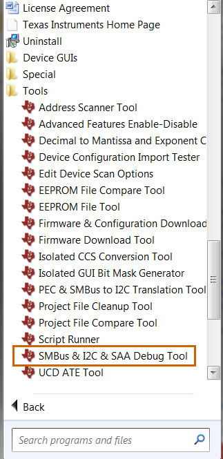

  • Download and install the Fusion Digital Power Designer software (not the Fusion Digital Power Studio), found here:
    www.ti.com/.../fusion_digital_power_designer digital power designer&tisearch=Search-EN-Everything
    They won't actually use the Fusion software, instead they will use a tool located in the Fusion Power folder.
    Navigate through the Windows Start --> All Programs --> Texas Instruments Fusion Digital Power Designer (folder) --> Tools (folder) --> SMBus & I2C & SAA Debug Tool.
    Basic tool that allows you to enter an address then write/read individual commands in I2C and SMBus with the USB-to-GPIO (SAA) adapter.
