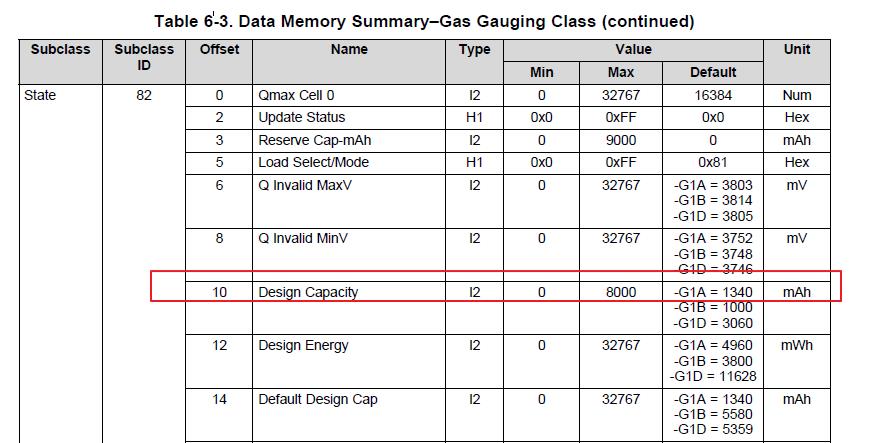

1) About the capacity of the battery on our project, please refer as follows:
>> Minimum Capacity  9300mAh (Standard Charge/0.2C Discharge 2.5V) at 25℃
>> Typical Capacity 9600mAh (Standard Charge/0.2C Discharge 2.5V) at 25℃
2) In the "bq27421-G1 Technical Reference" document (SLUUAC5B, June 2013 – Revised July 2016), in the page-28,
the Max of the "Design Capacity" is 8000 mAh.
3) The "Typical Capacity" of the battery is 9600 mAh. But the Max of "Design Capacity" of BQ27421 is 8000 mAh.
Q-3-1) Could the BQ27421 gauge support this battery (Typical Capacity 9600 mAh)?
Q-3-2) Could the Max (8000 mAh) of "Design Capacity" of BQ27421 gauge be modified?
