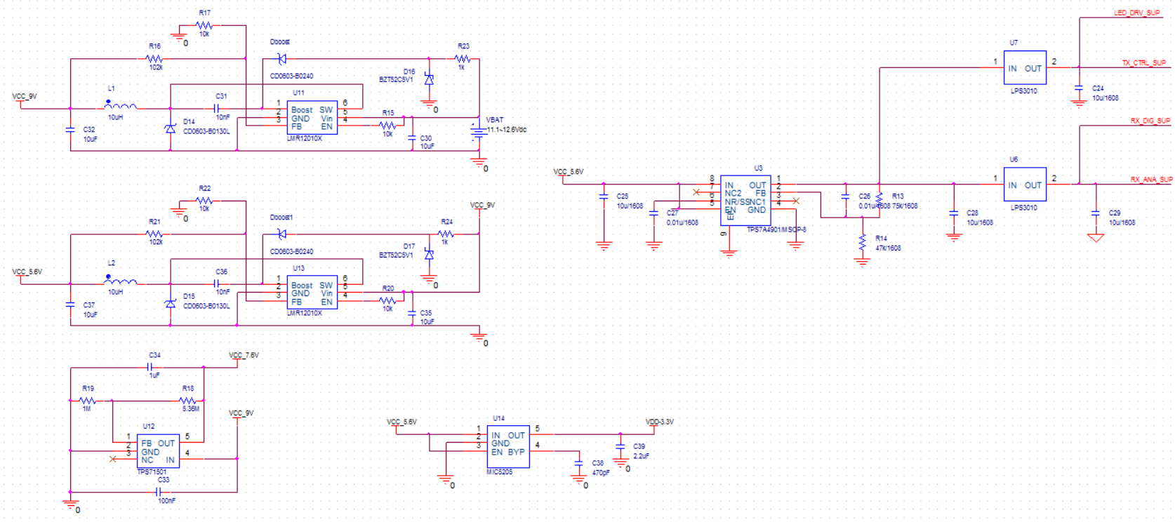

LMR12010x is burn
Other Parts Discussed in Thread: LMR12010

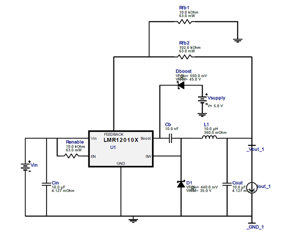

I use this circuit made by TI Webench.
I use 11.1V 30C 1300mAh battrey.
The spec of battery as follow.
●This Li-poly battery features high efficient and high discharge, use a inspection machine to match packs, suitable for MR25 series and other professional model airplanes, cars, and guns.
●Max Continuous Discharge: 30C(39A), Burst Discharge: 40C(52A). Normal operating temperature is approx. 40-65°C(within 80% of rated discharge). Max. temperature: 80°C.
●Recommend to discharge the battery within 80% of rated discharge, keep 95% capacity when over 100 cycles, keep 90% capacity when over 150 cycles.(The cycle life and efficiency will reduce due to high current, high temperature and over-discharge)
When i connect the battrey to LMR12010, the LMR12010 was smoking and LMR12010 was broken.
Is battery too storng to apply LMR12010?
