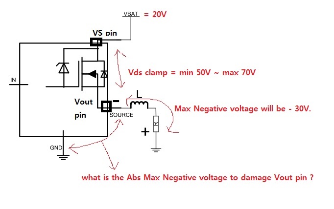

[Q4] what is the Abs max negative voltage between Vout pin and GND to damage the Vout pin as below ?
        in fact, we will apply Max 20V at VS pin, and expects Max - 30V negative voltage at switch off.
        we would like to know such Max - 30V negative voltage can damage Vout pin or not.

    The Vds is typically clamped around 60 V by an internal clamp circuit in case of huge negative output voltage. A max of - 30 V  won’t damage the Vout pin in your application. You can refer to datasheet 8.3.3 and the figure below for more details.

    [Q3] you said,,, Vds clamped at 60V. my application has VS pin = 20V and Max -30V.
            so Vout pin will not damaged because the internal clamp will not activated even.
            BTW,,, if VS pin = 40V and Max -50V, the internal clamp will be activated to protect the internal FET.
            in this case, Vout pin will be damaged ? customer want to know what is Abs max negative voltage to damage Vout.

    [Q3] The damage of internal clamp circuit relates to the energy of the negative spike. So it is decided not only by the abs max negative voltage, but also the current and time. We recommend Vds is applied below 60V.

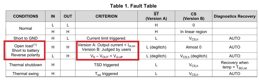

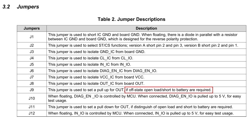

  • Hi Kenneth
    I finished datasheet review and realized that "Short to Battery" and "Reverse Polarity" Detection are using same (Vout > Vs) condition that the reverse current is flowing situation, but "Open Load" detection(Vs > Vout) is totally different from those two in terms of detection detail method.
    However, Table-1 say just one common criterion for "Short to Battery", "Reverse Polarity", and "Open Load" detection,
    so that i was very confused to figure out those 3 detection methods correctly.
    further, EVM said we needs the pull up resistor for the off-state open load/short to battery detection,
    so I asked  the pull up resistor is needed for "Short to battey" also.
    appreciated your help. thanks.
