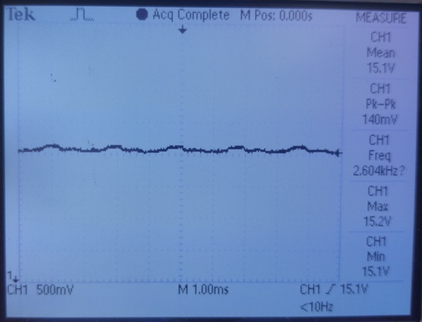

I am using the TPS65130 to generate a +/-15v supply, with max load current 50mA, please find the attached schematic.
TPS65130_SCH.pdf

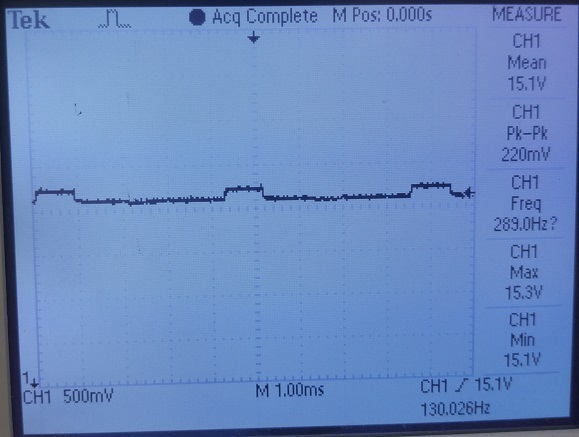

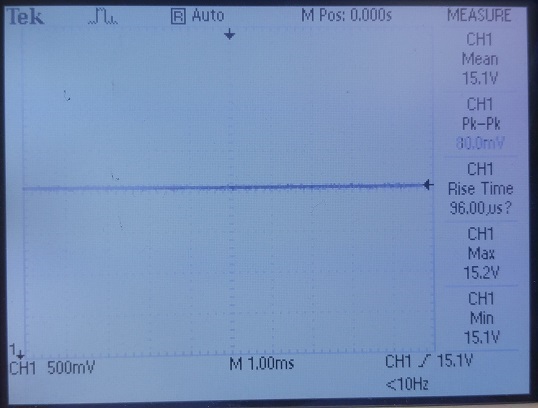

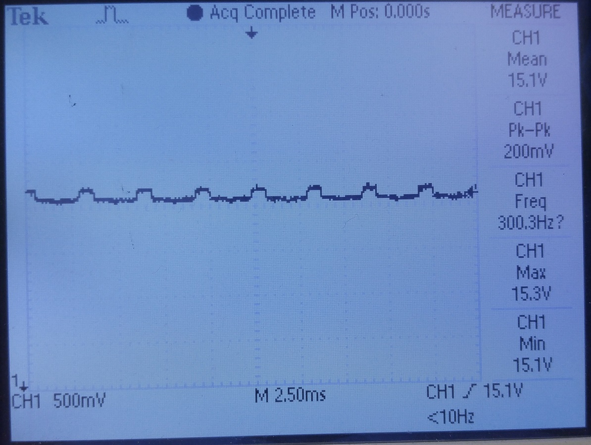

On the positive rail (VPOS pin), the output changes between 15.3v and 15.1v, as shown in the following image:

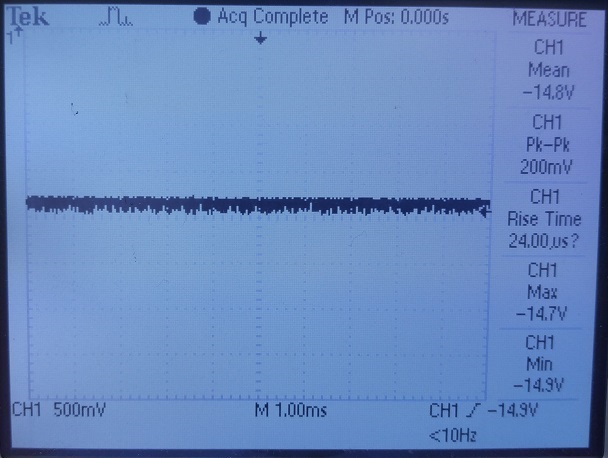

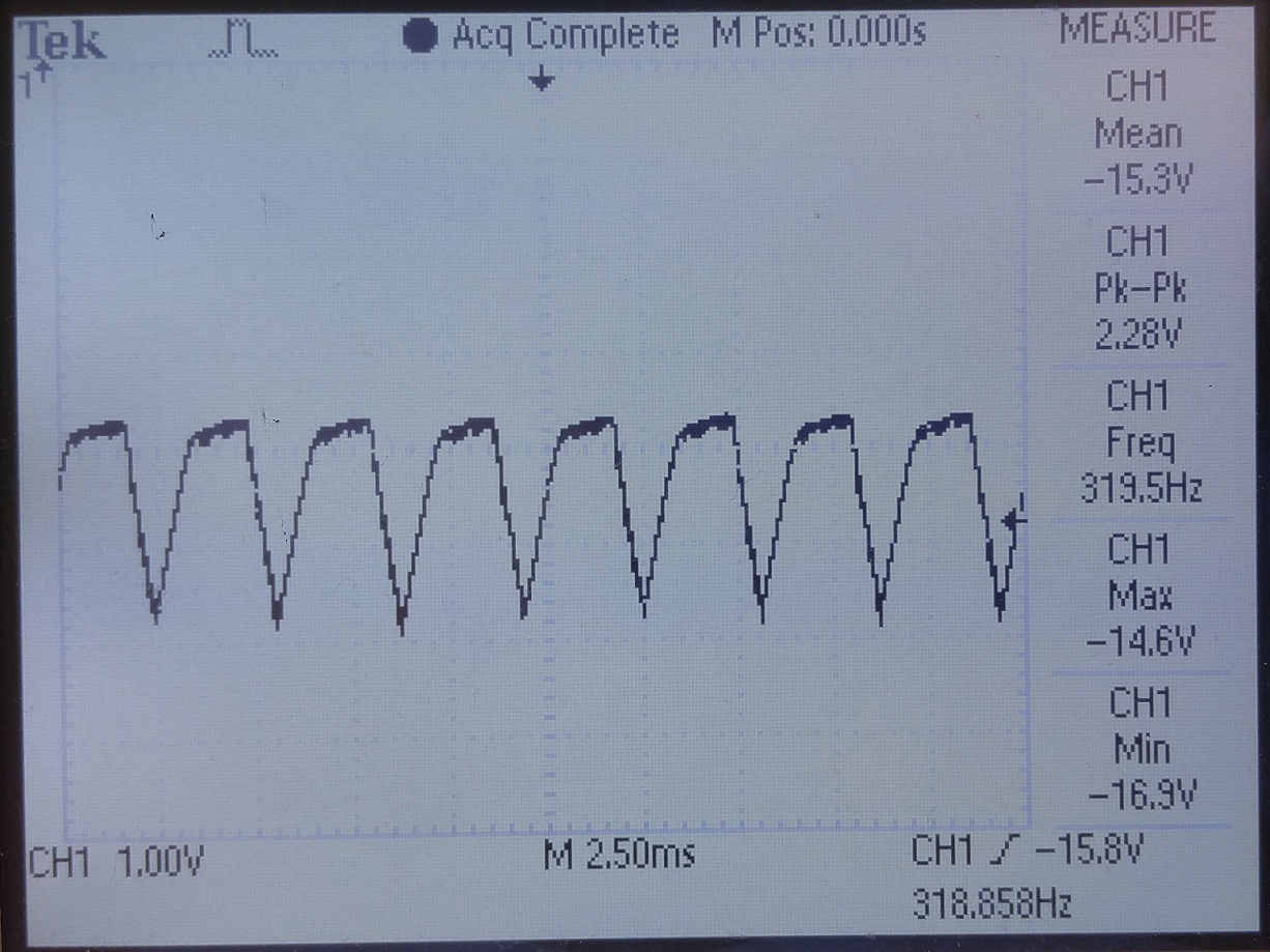

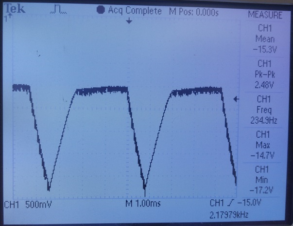

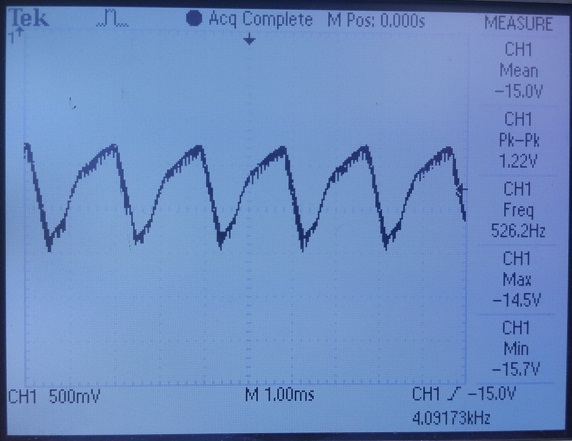

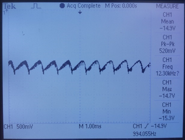

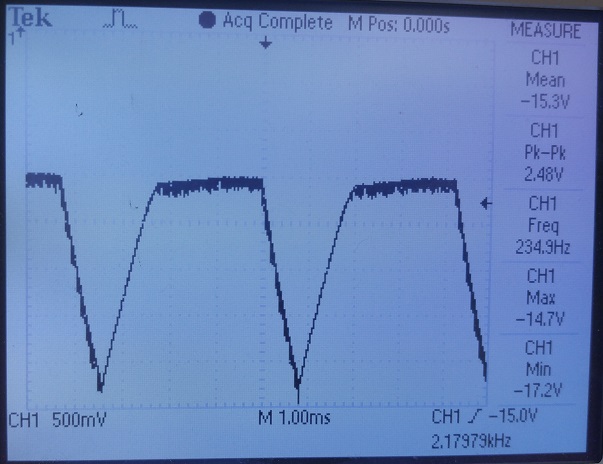

On the negative rail (VNEG pin), the output is fluctuating between -17v and -14.6v, as shown in the image:

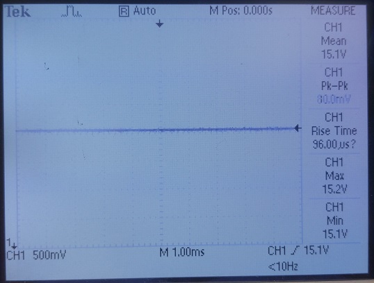

I have noticed that increasing the supply voltage from 5v to 5.15v solves the problem on both rails.

    I tried operating the board with different supply voltages, and found the following:
    1. Between 3.3v – 4.1v the outputs from +/-15v rail are stable.
    2. Starting from 4.2v ripples starts to appear on the output of the negative rail, while 15v remains good.
    3. From 4.5v – 5.2v, ripples start to appear on the +15v rail, and the magnitude of the -15v rail ripples continue to increase.
    4. After 5.3v the output of both rails is OK.
