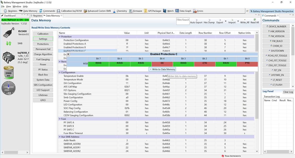

Some of the Enabled Protections C bit fields identified in the TRD do not agree with the corresponding bit fields identified in bqStudio and in the gg.csv spreadsheet generated by bqStudio. PTOS (Bit 1) and CTOS (Bit 3) in the TRD are identified as RSVD in bqStudio and in the spreadsheet. Which is correct?
bqStudio
Spreadsheet:
RSVD|RSVD|RSVD|OC|RSVD|CTO|RSVD|PTO

7                                  6                              5                              4
3
2
1
0
RSVD
RSVD
RSVD
OC
CTOS
CTO
PTOS
PTO
RSVD (Bits 7–5): Reserved. Do not use.
OC (Bit 4): Overcharge
0  =    Disabled
1  =    Enabled
CTOS (Bit 3): Charging Timeout Suspended
0  =    Disabled
1  =    Enabled
CTO (Bit 2): Charging Timeout
0  =    Disabled
1  =    Enabled
PTOS (Bit 1): Precharging Timeout Suspend
                    0 =   Disabled
                    1 =   Enabled
PTO (Bit 1): Precharging Timeout
                    0 =   Disabled
                    1 =   Enabled
