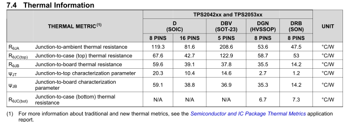

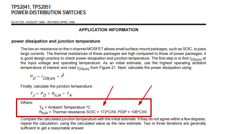

Is the thermal resistance value of TPS2051BDGN same as TPS2042BDGN?
Only TPS2042xx and TPS2053xx are indicated on a data seat.
The thermal #'s for TPS2051BDGN and TPS2042BDGN will be similar but not identical. Do you need the actual model #'s for TPS2051BDGN? I can generate an internal request for one but it will take several weeks.
I've submitted the request. Will post the model values when they are complete.
Here is the new model data for this request:
