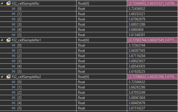

I am trying to piece together a squeeze routine to verify when a sense line is not connected to the battery stack.  We are using a single bq76PL455A-Q1 on a 6S pack which has been working quite nicely.  My questions are below.
1.) Do I use OV/UV window comp circuits or the AFE to detect the increased voltage on the N+1, N-1 lines when squeezing on sense line N?

  • Hi Stephen,
    Thank you for your prompt reply.
    I have implemented your suggested code and I have not seen any substantial movement on any of the sense lines.  Is there anything else that I am not considering when trying to get the squeeze resistors to work.
    Attached is a snap shot of the cell voltages without squeeze resistors, with the even squeezed resistors enabled, and finally with the odd squeeze resistors enabled. SampleNox[2] does not have its sense line connected.  As you can see, there is no change indicated when running the test.
    We have also added a 1 second delay and  decreased the input filter to a lower series resistance <100 Ohm. Any help would be greatly appreciated.
    Many thanks in advance,
    Matt
  • Hi Matt,
    Have you tried taking measurements with and without an open sense wire? There shouldn't be a significant change with and without the squeeze resistors enabled with a connected sense wire.
    Here is the same code, with more added detail. I am able to see ~2.7mV of difference between an open sense wire and connected sense wire.

  • Thank you, Stephen. I ran the test with the sense line connected and disconnected. I think the problem was looking for a change that was closer to the 72mV as stated on pag 43 of the datasheet. I will run it again looking for a smaller deviation.
  • Update:
    We were never able to see the voltage drop numbers posted in the data sheet for the squeeze circuit to detect an open wire condition.  However, we added the passive balancing FET/resistor hardware  and enabled this hardware one sense line at a time and therefore was able to detect a voltage drop.  The delta between this voltage drop when the sense line is attached and unattached is large enough for our system to determine that a cell sense line has been broken.
