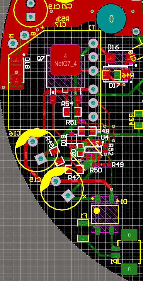

  • Hi Ulrich,
    Thank you for your detailed reply. I will attempt to filter the noise with caps as you suggested. In the meantime, here is a picture of the layout (bottom view, red is bottom and green is top). Please let me know if you see anything terrible I've done. Thanks in advance.

  • Hello Zac,
    There are a number of changes that I would recommend for this layout, but a verbal description would be very cumbersome for me to write and for you to read and interpret. I can make some drawing markups but that'll take some time.
    However there is one thing that stands out to me: the L2 filter inductor is directly opposite the control IC and CS input. I suggest removing it temporarily and putting a shorting wire from C15 to C16 to see if that improves things.
    Your post about the 100pF cap on CS just came in while I'm typing this. I'll continue with this reply. I don't recommend keeping the CS cap, at least not as large as it is. It should be as small as possible to "fix" the noise, but ideally, a new layout can fix it and eliminate the cap. This is because adding a cap doesn't guarantee the margin to the extent of the noise, which may be less or more on other boards as component properties vary. Better to eliminate the source of the noise if you can than try to muffle it.
    Having a cap on CS creates an RC delay for the Ipk sensing which alters the operating points along the control law curve and raises the maximum current limit. A small value can probably be ignored, but a long delay slows response to an overload condition which may overstress other components. Minimize it or eliminate it if you can.
    Besides the location of L2 (which could be moved to the space just above bridge D1), the GND feed to the controller should ideally follow the R48/D19/C20 path, not come from the D1 - pin. There are other loops that can also be reduced, but these two changes may have the biggest impacts. Of course, if you make any layout change at all, you may as well make all beneficial changes that can be identified, and that is a significant task to detail.
    In a nutshell, loops to minimize include:
    a) Xfmr primary/Q7/R54/C16 loop
    b) Xfmr Aux/R48/D19/C20 loop
    c) CS path R54/R51/CS pin/U4-GNd/R54 loop
    Check out the above debug ideas, and based on the results we'll take it from there.
    Ulrich

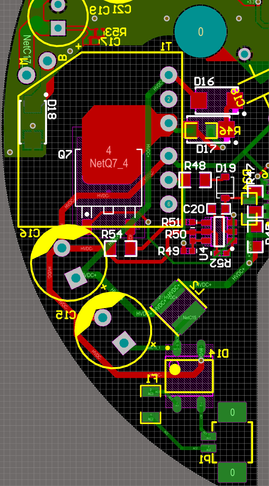

  • I will test shorting L2 and see if the EMF from that was causing issues. I have created a new layout, where I have moved U4 away from noisy components. I have also shortened the CS and VS paths greatly, as well as kept them out of the noisy paths (exception being the gate drive between U4 and Q7 crosses over them both, but still 61mil away). I have also more directly fed R54 and U4 GND from C16, and L2 is further away from U4 and the CS/VS paths. Your thoughts?
  • Hello Zac,
    I agree, I think this is an improved layout and should preform better than your earlier one. I do suggest one thing: to disconnect the HVDC- track from R50 and run it straight across from R54 to R52. This will reduce the loop area for the gate-drive current, which has a high di/dt at turn-off. That should help cut down on radiated noise. Compared to the gate turn-off edge, the other signals are slower and bigger loops there will have less of an impact.
    The CS signal loop becomes a bit wider, but the gate-turn-off happens after the CS signal has reached the turn-off threshold, so the turn-off di/dt will not affect the CS signal. You can reduce the CS loop a bit by making the track from R54 to R51 more of a right-angle and closing up the area.
    Good luck with your new layout. I hope it works out well.
    Ulrich
  • Hi Ulrich,
    Thank you, again, for the detailed help. Here's the final layout, taking into account your last recommendations. I have moved R54 closer to R51 in order to shorten the CS path, and supplied HVDC- to U4 via R52.
  • Hi Zac,
    Yes, that looks pretty good. I'd say it's time to fabricate a new board and test it out.
    Ulrich
