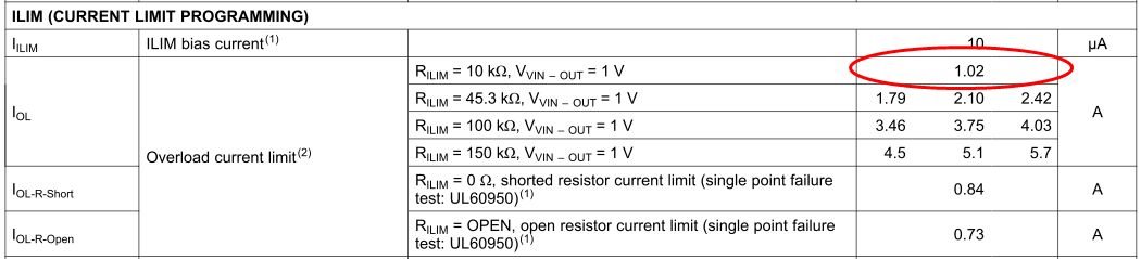

TPS25923 / Overload current limit at R ILIM = 10 kohm
Please let me ask about min/max of overload current limit, IOL. I checked the electrical characteristics and found that there is no min/max at only RILIM=10kohm. I understand that you can't guarantee it because there is not specified in datasheet, but I'd like to know its variation roughly. Should it be approx. +/-20% ?
