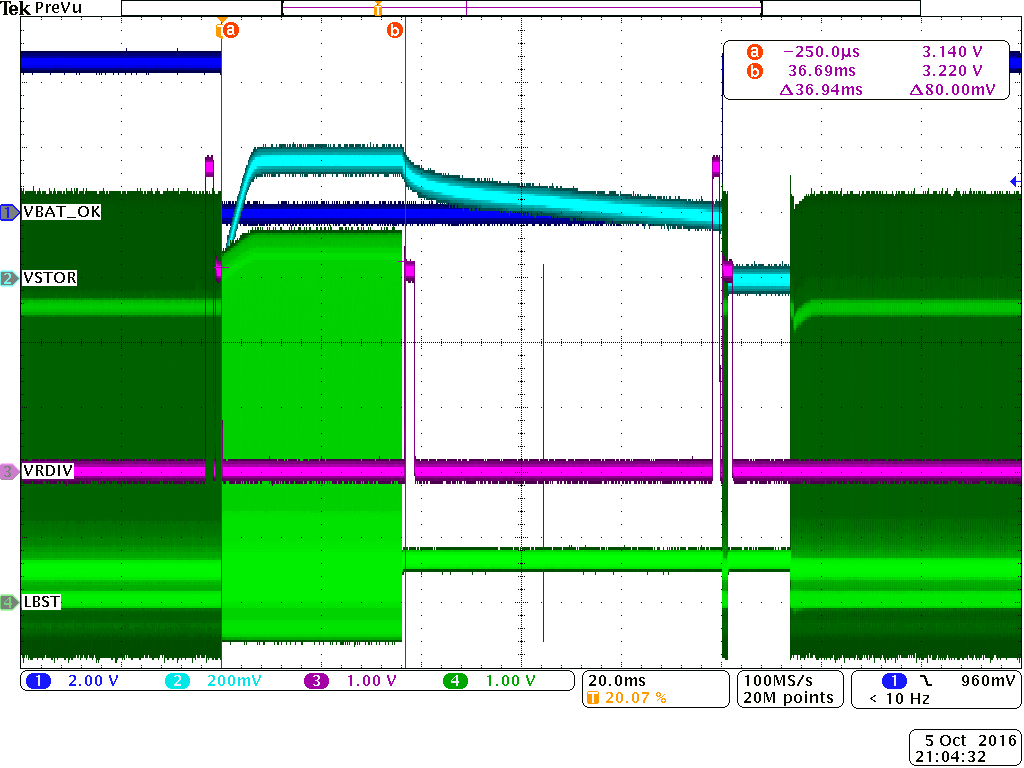

I have a design containing a BQ25504 device, which takes input from a single-cell solar cell (IXYS KXOB22-12X1F) and charges two supercaps connected in series (Tecate TPL-3.3/10X20F).  The BQ successfully charges the caps, but when they are fully charged, it often behaves like it's lapsing back into cold start mode, pulling VBAT_OK down and shutting off my downstream system.
The scope shot below shows this behavior when it happens.  Note that channel 2 - VSTOR - has a 4.7V offset; the shot below shows its behavior around a 4.7V base.
  • VBAT_OV set to 4.696V (ROV1 = 4.42M, ROV2 = 6.65M)
  • VBAT_UV set to 2.199V (RUV1 = 6.19M, RUV2 = 4.70M)
  • VBAT_OK set to 2.210V, VBAT_OK_HYST set to 2.804V (ROK1 = 4.53M, ROK2 = 3.48M, ROK3=2.15M)
I tried cleaning flux off the board and adding a small (15pF) cap across the lower resistors of the resistor dividers; does not change the problem or its severity at all.
How should I proceed?  What would cause the chip to re-enter cold start mode (thereby dropping VBAT_OK and turning off the VBAT - VSTOR PFET) when VSTOR is up at 4.7V?
Note: there are no transients on VSTOR that pull it down to the VBAT_UV (or, worse yet, VSTOR_CHGEN) levels prior to the reset.  I have verified this dozens of times.
  • Try adding a 0.01uF capacitor as close as possible between the IC VSTOR and VSS pins.  This cap should filter any noise into VSTOR that is causing the IC to lapse back into cold start.
  • This worked.  I added 2x 10nF caps from VSTOR to VSS, one on the front of the board and one on the back, with short wires.  Total length from VSTOR pin through the front side cap to VSS pin is about 5mm.
    With the caps, the system stayed stable for more than 12 hrs in a row.  When I subsequently removed them, the system resumed its behavior of rebooting (from VBAT_OK going down) every 5 - 10 mins.
    My existing board has a 100nF cap from VSTOR to VSS, but it is not as close as possible to the pins.  Total path length was about 10 - 15 mm.
    These 10nF caps may have solved the problem.
