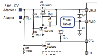

    To prevent any issues if the VBUS is connected, there is a circuit in the datasheet that provides redundancy to disable/enable OTG based on VBUS connection.
    If Vbus is connected, Q1/Q2 will provide power to the device while Q3 pulls low the OTG pin, disabling OTG functionality.

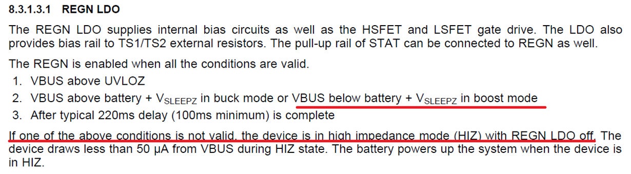

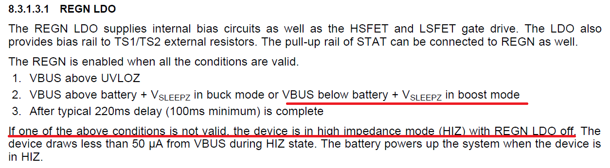

    Still have one confusion. If the VBUS has the 5V output, it looks the REGN can't work with the Boost mode as said in the datasheet. One of the condition for the Boost mode, is the VBUS< Battery +Vsleepz.
    If the REGN doesn't work, the boost mode shouldn't work in same time.
    So could you give me some suggestion for this?

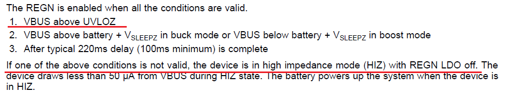

    If the VBUS no output during the BOOST mode. and VBUS should be < UVLOZ, and the REGN LDO should be OFF as said in the datasheet. If there is no REGN, it looks the BOOST mode can't work, there is no driver for the MOSFET.

    Is there some mistake in the datasheet? As in boost mode the VBUS should be low, the Q1 Off, and Vbus should be < UVLOZ. As in the datasheet said, the REGN should be off. Could you help check it?
  • Hello Wu,
    The conditions you are referring to on the datasheet for REGN enable are correct, as well as the HIZ mode with REGN LDO off. Perhaps the item that can be added for further clarification is that during boost mode, without VBUS connected or VBUS below battery+Vsleepz, REGN is powered from the battery. while battery is above BATLOWV.
