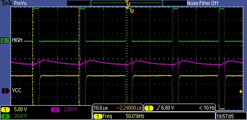

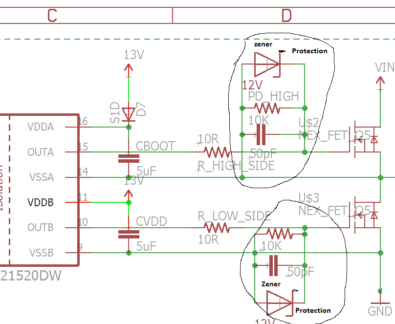

I create circuit for 65V. Via regulator I supply with 13V.
High side I supply via  Diode and Capacitor from 13V to drift with 13V (charge pump) from P1.
Low side directly from regulator 13V
I Limit the current outputs with 10 Ohm resistor => 13V/10Ohm=~1.3A . Work at ~50Khz.

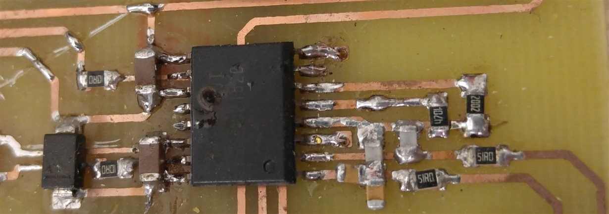

But the driver is support up to 4 Amps. Why broke? I place a Picture with broke circuit.
