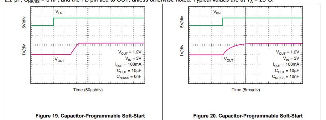

Is there a problem to increase the cap at the NR/CC pin to lets say 47nF or even 100nF?
  • Hi Jan,
    Please note that the NR capacitor will change the startup waveform from linear to an RC charging curve.
    Another way to help provide the inrush current is to increase the input capacitors for the LDOs and delay the enable of the LDOs. The input capacitors will then help supply the inrush current.

  • Ryan,
    If I would remove the NR cap the output will rise linearly right?
    Does that means that under a large capacitive load (600uF) the current limit kicks in and the output voltage will rise linearly with a 220-500mA constant current (TPS7A4901) until the buffer caps are charged and the output is in regulation?

  • Hi Jan,
    Yes, without the NR cap, the output will rise linearly as shown in Figure 19 of the datasheet.
    There is a short period before current limit will engage where the LDO will allow inrush current to charge the output capacitors.  After this delay, the current limit will engage.  At this point the current will be a constant 309mA (typ) until the capacitors are charged.
    Please note that current limit is designed to help protect the regulator during fault conditions and is not intended for extended use.  You may want to consider a higher current DCDC for a more reliable design.
