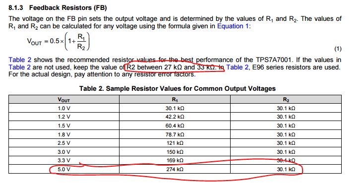

    One thing to point out with regards to your schematic is that your resistor divider is not within the operating range listed in the datasheet:

  • Hi Ryan,
    we have changed R2 to 33k, but it still happened sometimes, TPS7A7001 output is around -0.4V.

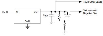

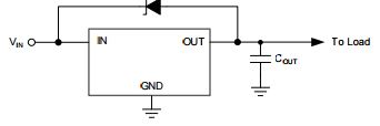

    When power down, how can we make the negative voltage on the output of tps7a7001 disappear as soon as possible?
    kerb
  • Hi Kerb,
    There are a few application work around concepts that can help when an LDO is negatively biased.  It seems that the last two will be more useful for your application.
    • Enable the device before the negative regulator and disable the device after the negative regulator.
    • Use an external pulldown resistor.
    • Place a zener diode from IN to OUT to provide a small positive dc bias on the output when the input is supplied to the device.
    • Use a PFET to isolate the output of the device from the load causing the negative bias when the device is off.
