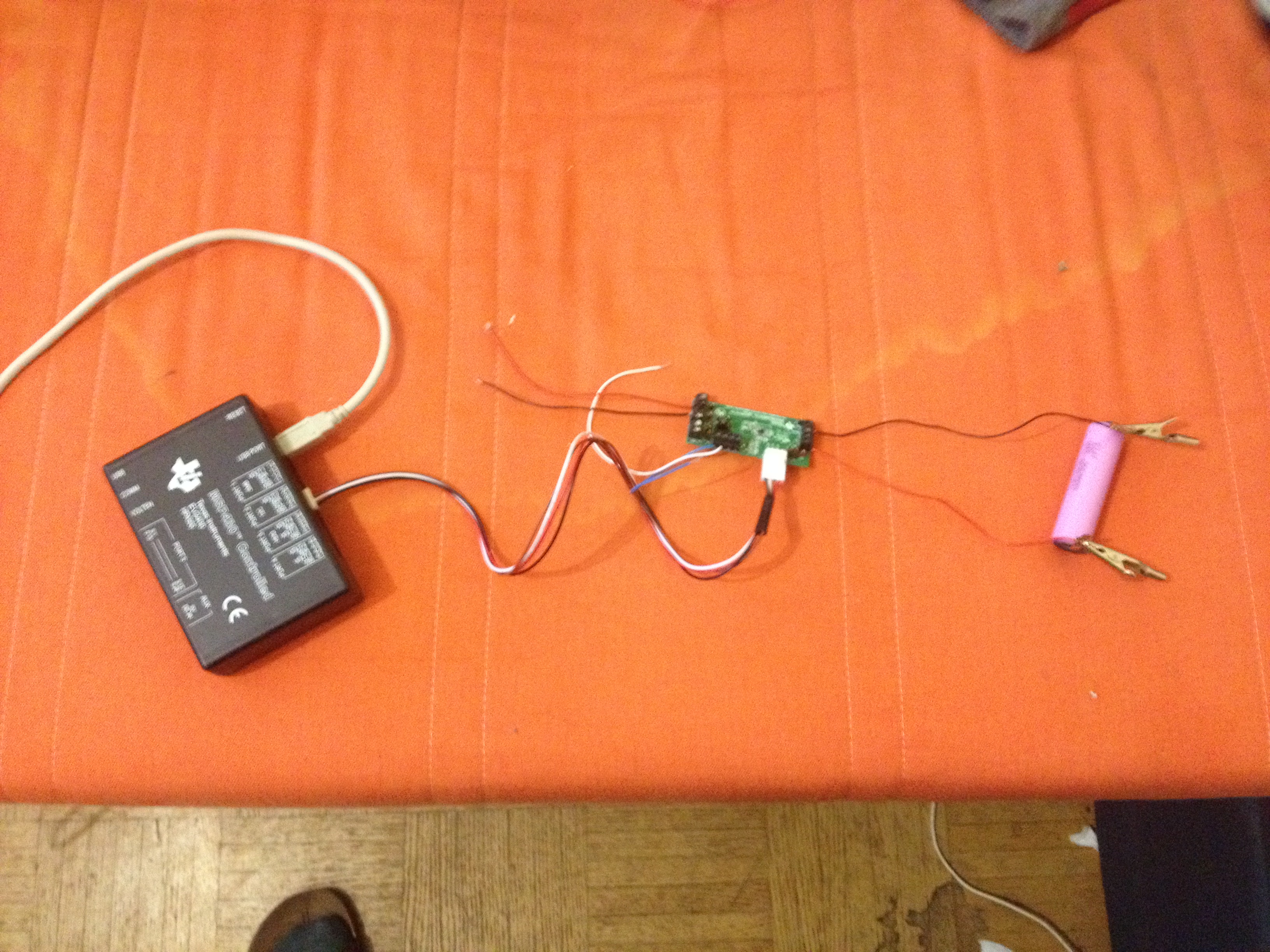

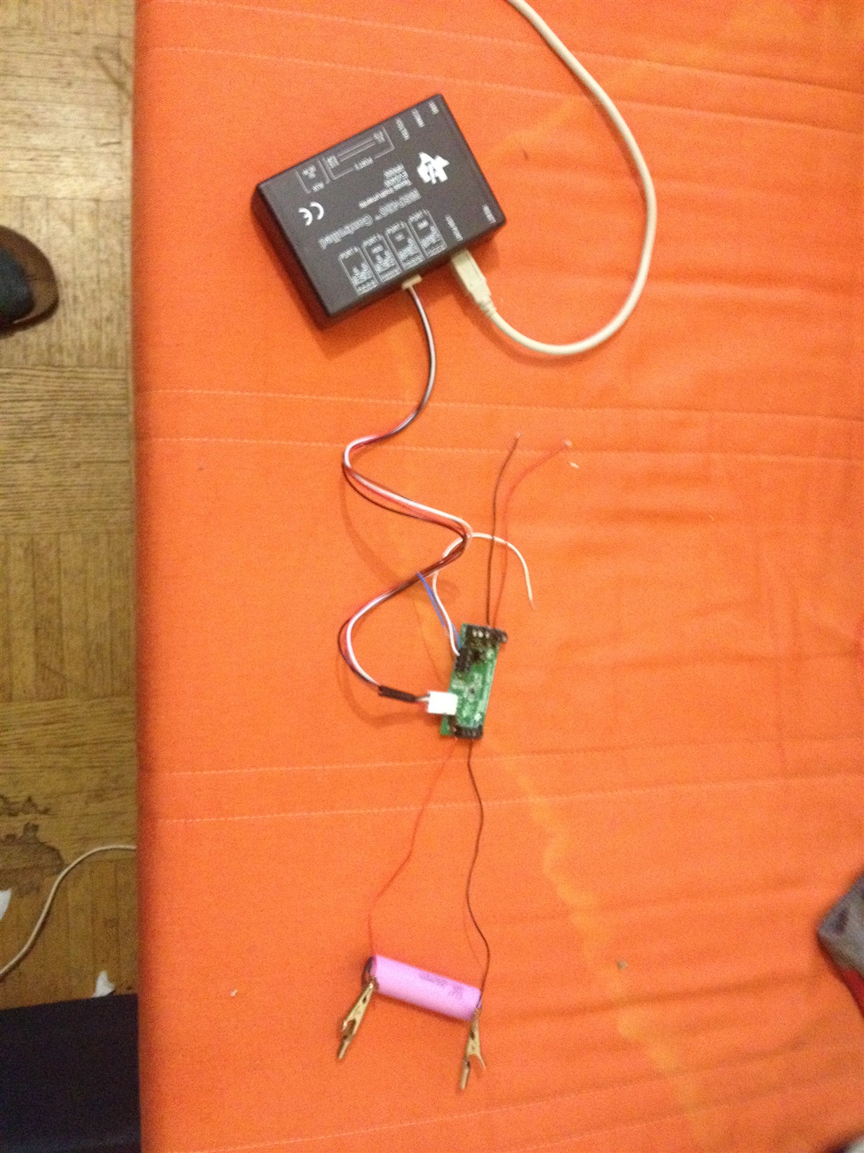

  • Sir;
    First I just connect battery to the pack+ and Pack- and with the help of Ev2400 I check that is the software working or not but it doesn't not connected to the software,
    Then I checked the connection and more than 10 times then I think checked that what is the problem then by using (DMM) Digital multimeter I checked the connnnections, so I saw that Pack+ and Pack- is short with each other.
    And by using the power own like making the connection it's good my to hot.
    Regard: Zeeshan

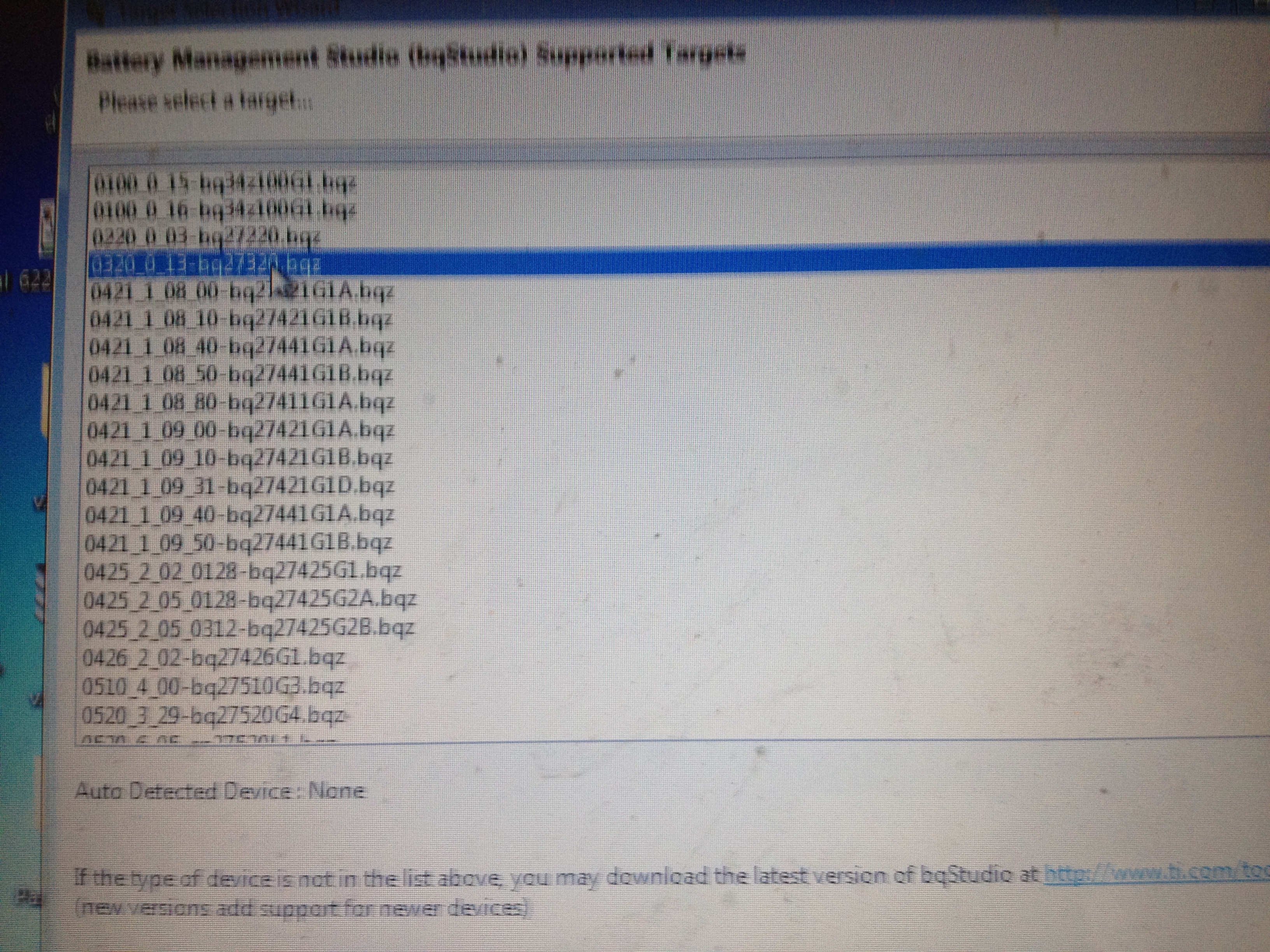

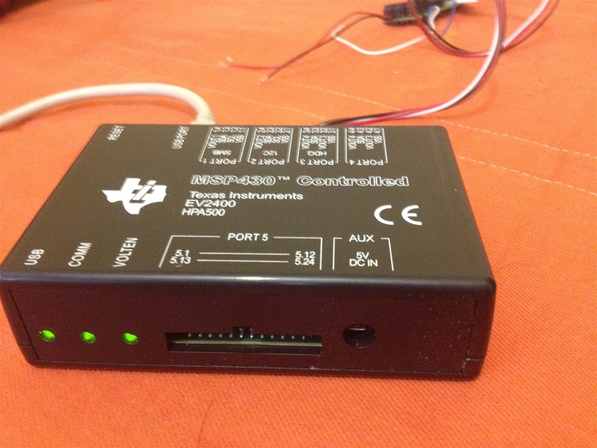

  • Hi Zeeshan,
    Does the light of your EV2400 turn green? Let's check it first, please make sure that you connected your EVM with right I2C.
    If it is right, could you give me a picture of your connection?
    At the same time, please make sure you choose the right gauge in BQ studio.

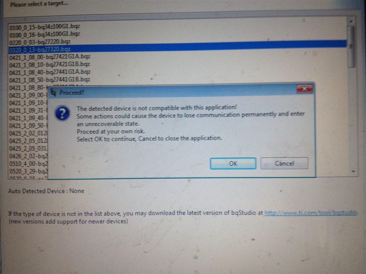

  • Hi zeeshan,
    1. When link gauge to BQ studio, the display screen just means that the software did not automatically detect the gauge, but you can continue click OK, and it won't hurt the gauge.
