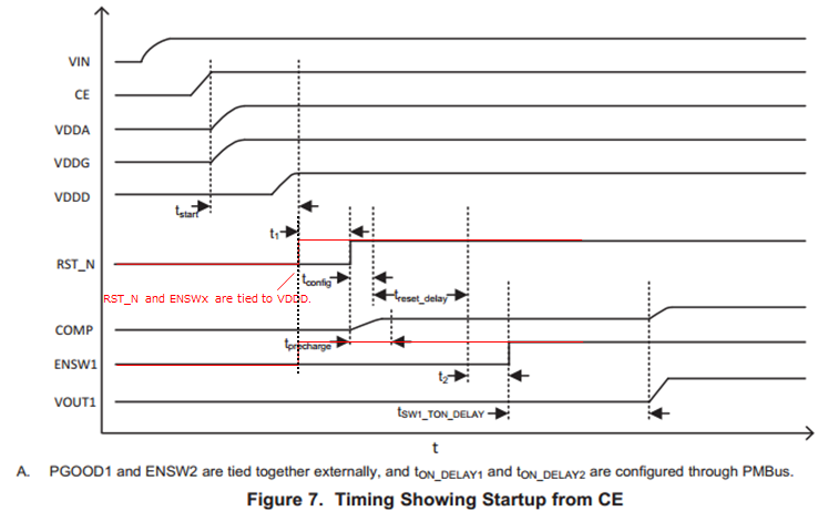

- Default Vref is 0.8V, but my customer found the Vref is 1.87V before programming through I2C.
  Why does it happen?

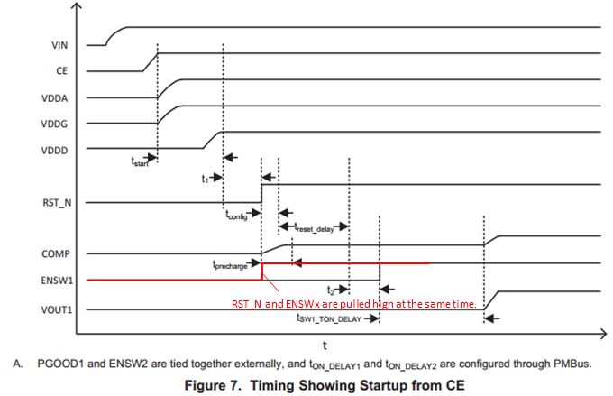

- When the IC is start-up, RST_N and ENSWx are pulled high at the same time.
  They considers this sequence is out of spec.
  Is there any possibility to destroy the IC at this sequence?

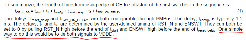

    And I want to confirm about sequence.
    According to datasheet, I think RST_N and ENSWx can be tied to VDDD.
    So if RST_N and ENSWx are tied to VDDD, these signal(VDD, RST_N and ENSWx) will be high at the same time.
    Is this sequence ok?

    The priority is :
    CE > RST_N > ENSW1
    So even though RST_N and ENSWx are high at the same time, the startup sequence will not be changed, there is no risk.
    However, the softstart(SS) must be began after COMP precharge finished.
