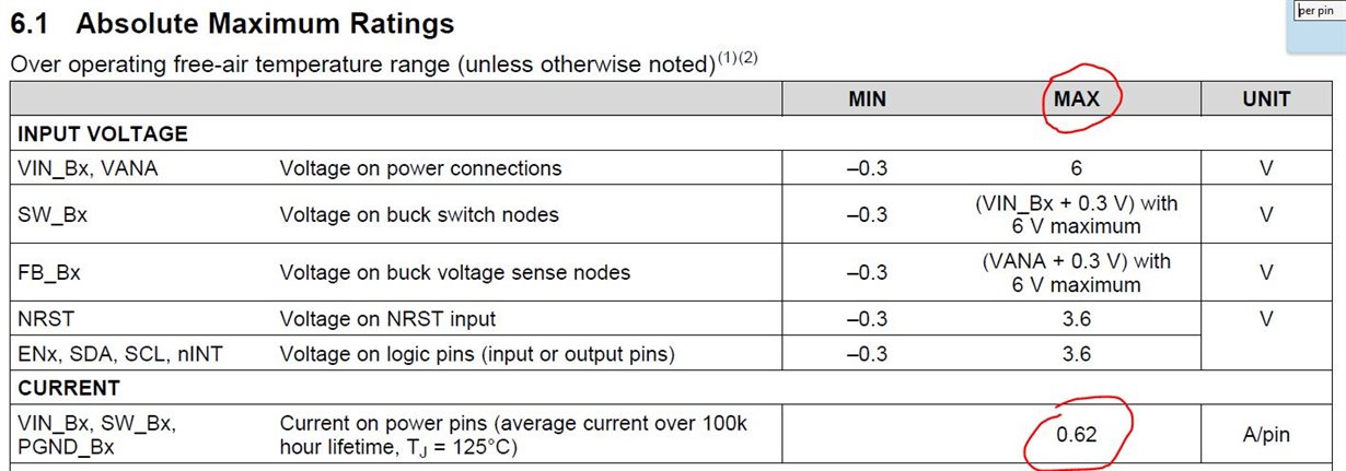

LP8758-E0 Abs-Max Current
I'm writing about the abs-max current located on page 5 of the datasheet.
The device is rated at 4A per output; but, if each output has 2x SW pins, then the maximum inductor current can not exceed 1.24A, thus limiting output current.
Some questions:
1. I notice that this is spec'ed at >10 year lifetime when operating at 125oC.
a. If the junction temperature is lower than 125oC, will this current be increased?   If so, by how much?
b. Is there a graph that relates maximum current to expected lifetime of the device?
2. I suspect that this figure stems from electromigration in the solder bumps.   Please confirm.
3. What's the failure mechanism if the above spec is exceeded?   Cracks in the solder ball?
Don
