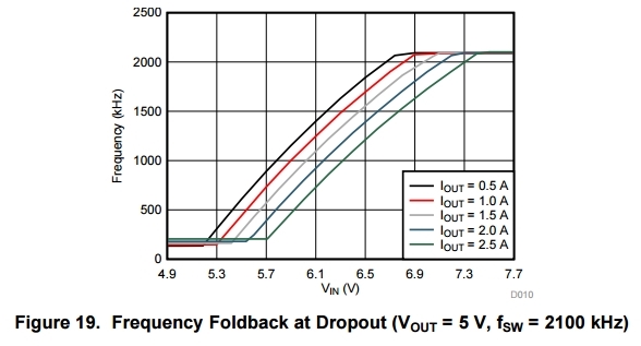

I have some question about LMR23625.
1. Regarding the operation when the pulse width is hit to min on pulse.
The pulse skip will be happen when the pulse width is hit to min on pulse. or continue to keep the min pulse at PWM?
2.Regarding frequency fold-back.
How is the frequency reduced ? Step by Step(e.g. 1/2 -> 1/4 -> 1/8)? or linearity?
The following data is shown that the frequency is reduced at linearity.
3. Regarding the boot resistor at the series of Cboot.
How much the Rboot should be? (Maximum)
