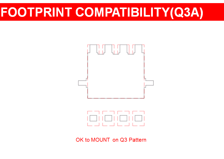

under www.ti.com/product/CSD25401Q3 TI proposes the CSD25402Q3A as a pin to pin alternative.
But looking at the mechanical drawings I am not sure if the CSD25402Q3A can be soldered onto a CSD25401Q3 layout.
The recommended PCB patterns look different and the distance between the pins is also different.
Please advice.
