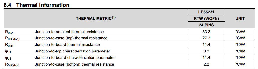

Hi Sir,
Could you provide the value of Psi JT to me?
Because I cannot find it on the datasheet.
I believe the answer is the 4th entry in that table. 0.2 C/W
