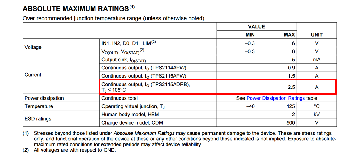

  • Hi Ryuji,
    According to your calculated RILIM = 190ohms, your 2A (min) current falls within max recommended operation for the TPS2115ADRB, please see screen shot from datasheet below.
    Also your calculated 3.28A (Max) current will fall above the absolute max ratings for this device, please see screen shot from datasheet below.
    So it is not recommended to use 190ohms RILIM.
    Haidar

  • Hi Ryuji,
    So your TPS2115ADRB device will be operating with a current level above 2A (min) which is the limit for max recommended operation current for this device and that's why it is not recommended since your are stepping in the gray area between max recommended operation condition and the absolute max ratings for this device, but I can suggest another device that might be more suitable for your application, please check the TPS22981 power mux. The TPS22981 has more features than the TPS2115A, please let me know if you have further questions.

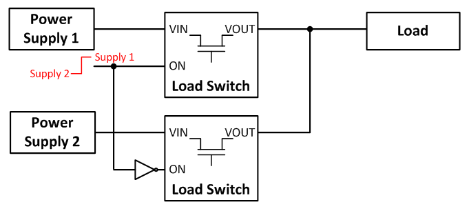

  • Hi Ryuji,
    Thank you for the information.
    In general, power muxing can be accomplished using two load switches with reverse current blocking. Since you need >2A, I would either recommend two TPS22963C devices or two TPS22953 devices. The configuration for these load switches can be found in the drawing below.
    Also, you can find more information about the power muxing for the TPS22953 in the datasheet (section 10.1.6). Let me know if you have any questions.
