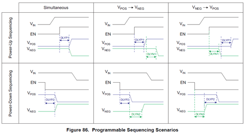

1.Default sequence of TPS65132W and TPS65132S.
2.SCA and SDA pin terminal processing in not using I2C case.

    1) The default setting for the power-up sequence is described on figure 21/ table 6. They start-up simultaneously:
    2) If I2C is not used you can either set SDA/SCL to GND or to VI.

    Customers want the TPS65132 to start up in the order of 'Vpos→Vneg'.
    However,default SEQU [5:4] Value(Power-Up Sequencing)→‘0’=Simultaneous.
    When not using the I2C,Is there a way to achieve in the default setting state?
    Coud you give me your advice?
    Yusuke/Japan Disty
  • Hello Yusuke-san,
    VPOS and VNEG have separate enable. So customer could have a delay between EN(VPOS) and EN(VNEG) to get the desired sequence.
