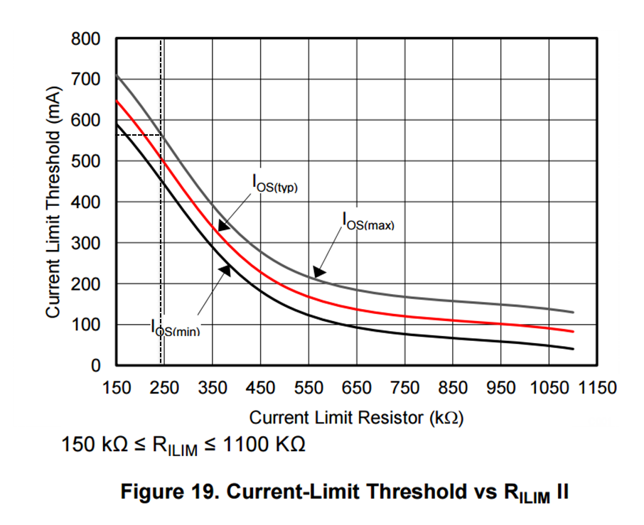

We got a question from customer about TPS25200.
Could you help us?
[Question]
- How much is the variation of current limit by Rilim=243k at the over temperature?
  My customer need the vriation falls within the range 300mA to 500mA.
tateo
  • Hi Tateo,
    As you can see on screen shot from datasheet below, when RILIM =243 khoums, Ios(max) is approx.. 560mA, even the Ios(typ) is slightly over 500mA.
    So it will not fall within (300-500) mA current range as your customer want.
    Haidar
