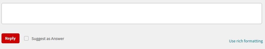

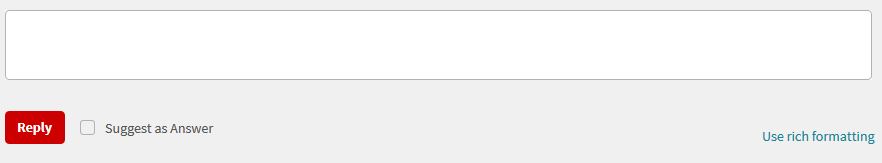

  • Hi Tom,
    I must be daft - or something. I'm using Firefox on Windows 7.
    Below the window where I'm typing this text, I see only the Tags window, the check for notification of replies, the spot for BCC to other, the check box for "Suggest as an answer" and the '"Post" button. No area for comments...
    Do I need to use another browser or have some option turned on?
    Thanks, Dave
  • I use Firefox, so that is not the issue. This is the Rich text comment that I mentioned. If you do not see this, then you should be able to drag the file into the window or click the paper clip to upload the file.
  • Hi Tom,
    In my case, the "Use rich formatting doesn't how. When I follow the paper clip approach, here's what I got. Maybe it's working, but it's not obvious to me.
    Thanks, DavePitchforkBattery.zip
