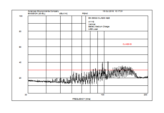

We went to EMI pre-scan in the past two days with a new product. We are aiming for class B certification, and fell very short. One major issue was with the TPS61235. It's throwing off a ton of noise in the 100-140 MHz range.

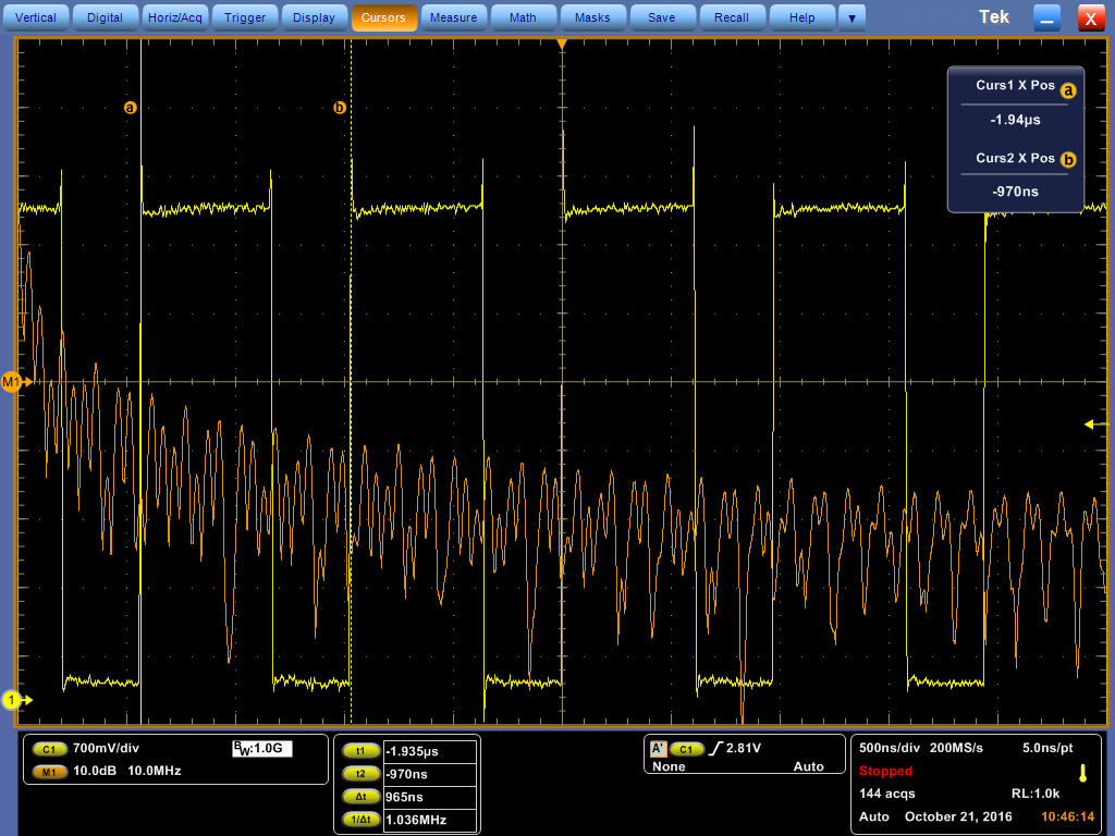

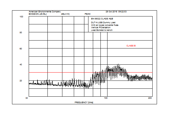

We have already tried switching to a better-shielded coil and a larger output ferrite bead, but this was still not enough to bring our device into spec.
I've begun the process of finding a new part for a 5 V boost converter under the assumption that there is nothing that can be done to save this part, but if there is a way to get into spec it would save a lot of effort. The schematic is shown below:

Below is an image of the EMI scan. The largest 2 spikes are radio stations, but the rest is coming from the TPS61235.
