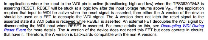

Can disable WD function of TPS3820 with MR pin?
Tomohiro Nagasawa
  • Hi Tomohiro,
    When /MR is pulled low, /RESET is held low.  As a result, the watchdog functionality and voltage supervision functionality are ignored.
    Please note that WDI must not transition while /RESET is in a logic low state unless decoupled per the datasheet.
