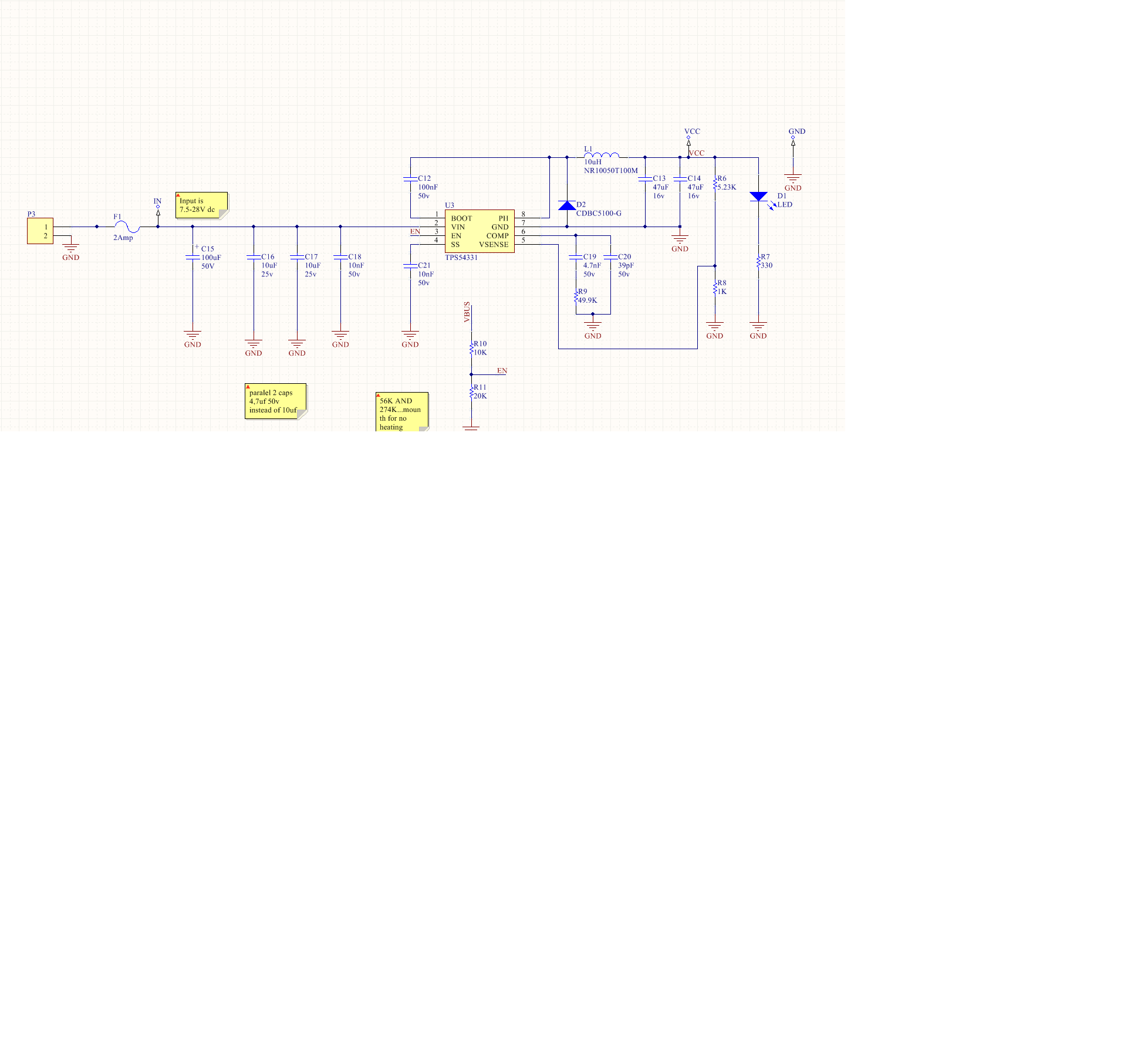

here is my schematic
  • What do you mean by "flashy"? Your schematic seems ok. Can you post your pcb layout? Ans some waveforms during normal operation including the PH pin and VIN?

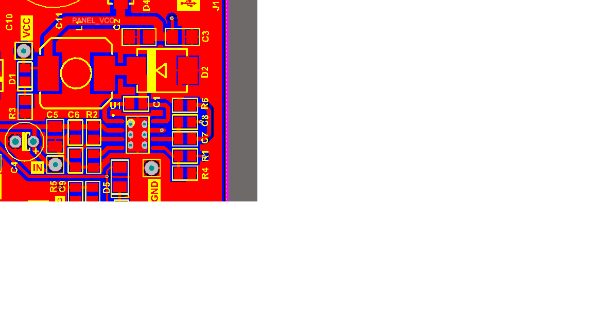

    here is my PCB layout:
  • Those EN resistor values seem extremely low.  Try Rtop = 169k and Rbot = 32.4 k.  Your layout looks like it has issues as well.  The input caps should be closer to pin 2.  Move the EN resistors away.   The ground path at the catch diode is blocked by the BOOT resistor.  Even though it seems like a "direct connect" from pin 8 to pin 1, don't do that.  Leave a fat top side ground trace there and use a via to connect the BOOT cap on one end.
    All that being said, you may have damaged the IC.  You should probably replace it.

  • Hi
    This is my new Design and i try to consider john's tips.
    How is this?
    (one of the net is for EN pin because i want to turn TPS54331 on/off with another signal in my design)
  • Generally that looks better. I would flip the catch diode and inductor horizontally to minimize the SW node and GND paths. You can rotate the inductor 90 deg so the SW node pads are directly adjacent. You can route GND path under the IC. Flip the input caps vertically and route to GND at the top of the IC as well. See the datasheet layout guideline and look at the EVM users guide layout. The EVM layout could be improved by moving the L1 and D1 to the right so the D1 GND pad is directly above the IC, making the most direct GND and SW node paths. Finally, get rid of the 2 thin (thermal relief?) traces at the exposed pad under the IC.

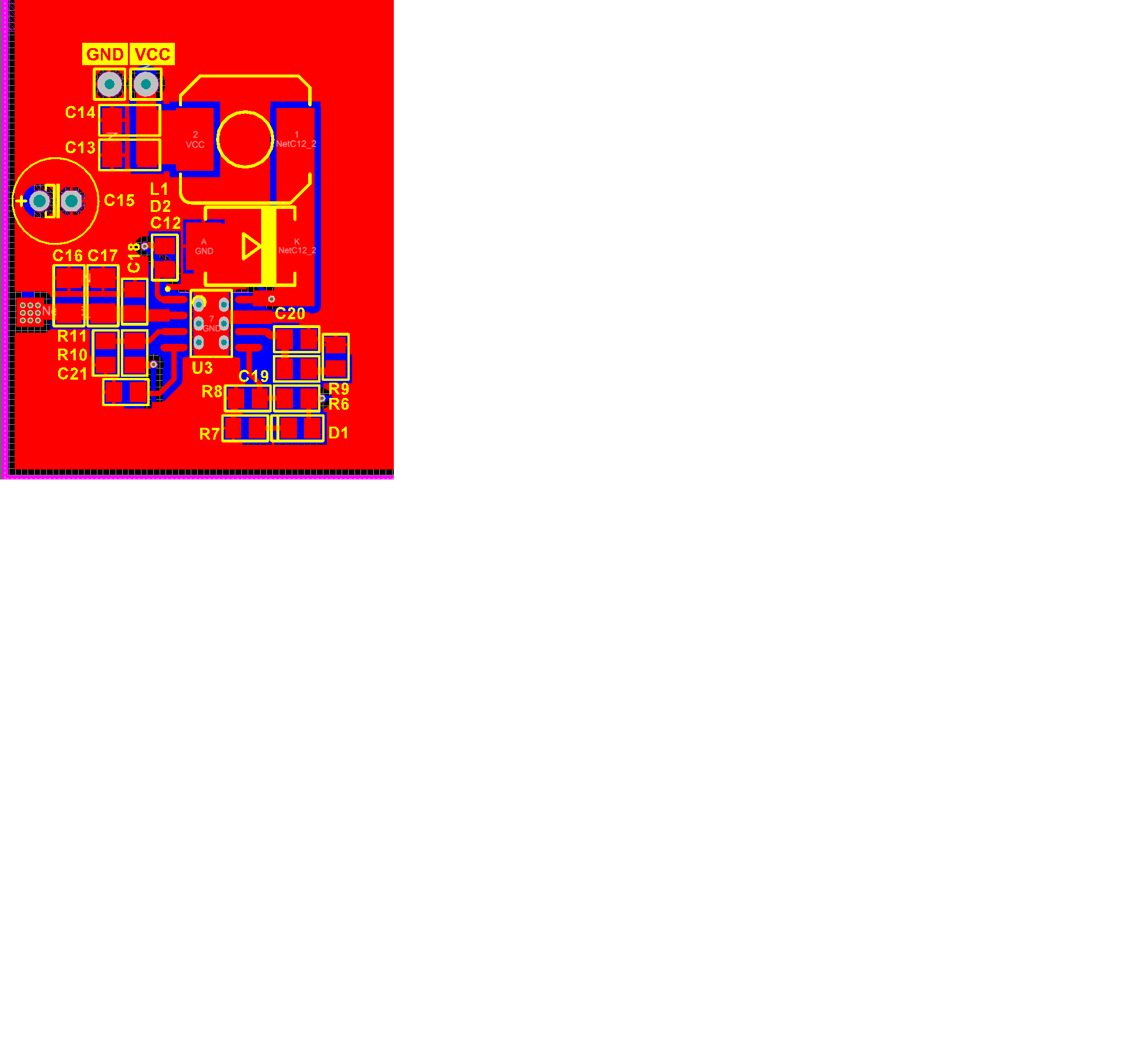

  •  Hi john
    This is my Final Design i looked at EVM board and Layout Guidelines.
    I rotate SW component on top of the ic and now i have clean direct GND path .
    How is this?is it professional ? :)
    (i should be worry about final size of this module on my PCB)

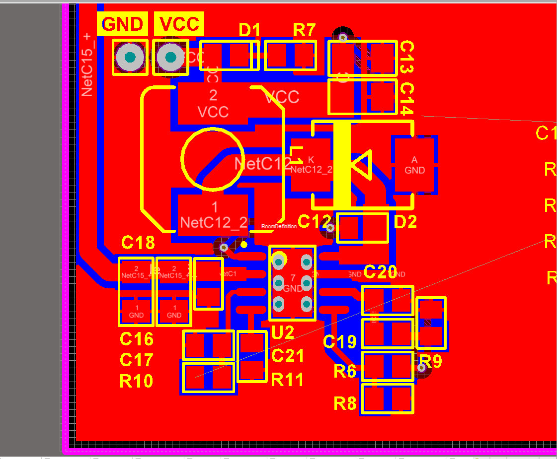

  • Hi john
    could you please look at my design if there is any layout problem?
  • That looks good except you still have the thin traces from the thermal pad to the main copper pours. Can you make that a solid fill or increase the number of traces?
  • Hi
    thank you john for your reply ..without your help i cant dont that.
    this is the other design .but i have some question:
    my current PCB as i say it dosent works well(its flashy and ...)why it dosent work?does it matter to catch diode placement in my PCB and layout problem ?i change my IC two times but it dosent works!
    2-i use via to connect cap on BOOT and PH pad ,but the PH pad is on bottom layer .is this cap important and the placement is necessary ?
    3-as you see in picture i have 3 polygan part on top layer (there is no polygon on right side) and im worry about ground path because the input conector is on left ,top the board and the GND polygan does NOT direct connect to TPS54331 circuit (should i use via on top of the tps54331 circuit?)
    thanks
  • 1.  I suspect your underlying cause is probably the choice of EN resistors.  But it is very important to have a good PCB layout as well.  Did you try the EN values I recommended?
    2.  It ok to use that method for BOOT cap connection.  That is how I do it.
    3.  I se your point here.  You will have to find some way to directly connect your input GND to the IC GND.  You could move everything over to the right and place the GND connection adjacent to the VIN path (and maybe widen VIN a little as well).  Or route it on the bottom side (which I assume is mostly a GND plane anyway?).

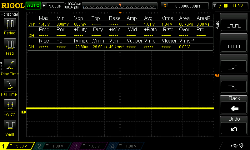

  • Hi john
    this is some waveform of my circuit that has problem(flashy!)
    i have something like this on PH  pin BOOT pin
    and this is my EN pin:
    im confused! i just have a voltage divider on EN pin but its 1.4v!!! and my input is 24v
  • EN should be around 4.27 V. with 1800 and 390 or about 3.86 V with the values I suggested.You must have a fault somewhere. Either you are damaging the IC or there is some external fault for you to find. You will need to find this before proceeding further.

  • Hi
    these are my schematic and my layout.the
    vin=19.5v,
    vout =5v,
    Iout=appr. 200mA
    when its not working i think the mosfet is turn off!because idont have any output!
    i have led indicator for output voltage thats flashy!!
  • flashy.rar
    this is video of the flashy state of the circuit when the boot cap was regular(i dont replace it with X7R one).
  • I don't see anything that jumps out at me for the schematic or layout. I'll have to see waveforms.
