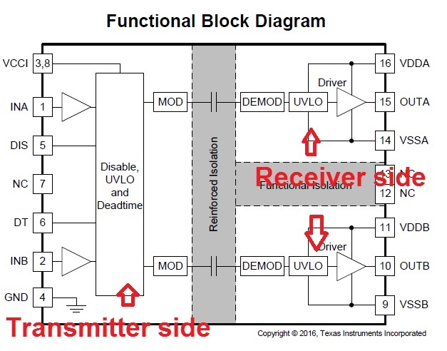

It is write as"Power dissipation by transmitter side of UCC21520" in the data sheet P5.
What loss is this occurs from pins?
Regard
T Kishi
  • Hello Kishi,
    Thanks very much for your questions. Here is a picture describing transmitter (primary) side and receiver (secondary) side. The loss in the transmitter side means the loss the transimitter side chip. I will help improve the datasheet for clarification.
