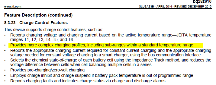

  • As an addendum to my original post, I came across this in the datasheet for the BQ28Z610.
    After coming across this, I now understand the intended use of the temperature sub ranges. My original question is in regards to what seems like redundant temperature protection thresholds. If the OTC and OTD parameters act as max temperature protections, then do the temperature sub-range thresholds also act as redundant protection to an extent?
