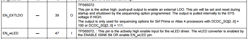

Hi
My Customer has question.Please cooperate me.
It is write as"Pin Configuration and Functions" in the data sheet P5.6.
Please see the attached file.
Regard
T Kishi
TPS65070.pdf
  • Hi Kishi-san,
    Thanks for pointing this out, I can see how this would be confusing as it appears the titles for the columns are swapped. EN_EXTLDO (39), and EN_wLED (47) are only available for the TPS65072.
    The TPS6507x devices instead have RESET (39) and THRESHOLD (47).
    Thank you for bringing this to our attention.
