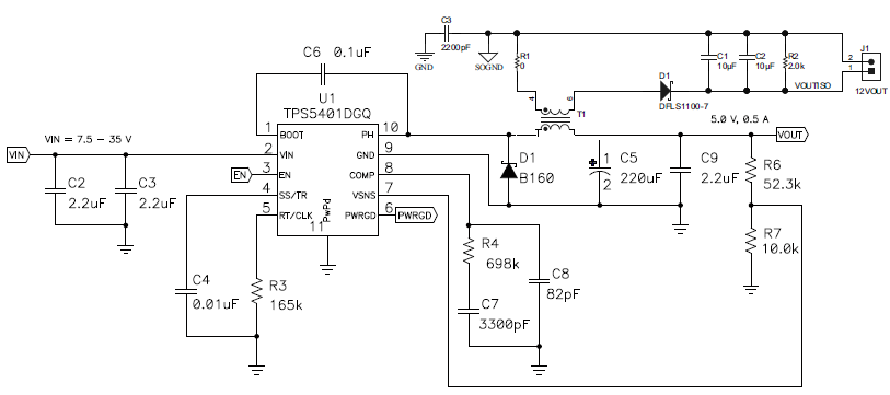

Dears,
There have a case need isolated power supply,whether can we use the TPS5401 to design isolate output as below. Many thanks!
Dear John Tucker,
Thanks for your reply! According to your means, the TPS5401 can be designed like above.
And, I want to know that the difference between isolated and non-isolated DCDC converter in TI. If the non-isolated can application to Isolated, how to choose a suit chip for my design.
Waiting your reply! Many thanks!
