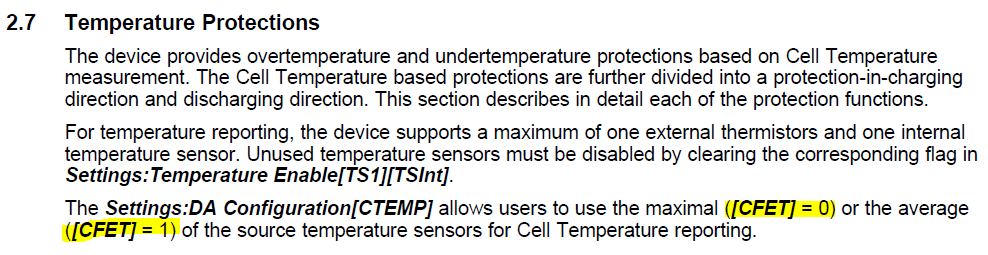

BQ28Z610 CTEMP Using CFET Bits?
For the following...
...it seems odd that the CTEMP setting would use the CFET bits which are for Permanent Failure scenarios which would make them dual purpose. I believe these should both say CTEMP instead of CFET. Could someone confirm?
Thank you for your time.
Blake
  • Hi Blake,
    Correct. That is a typo in the TRM. Moreover this device has the option of just using either the 1 ext thermistor for temp measurement or the internal temperature sensor for temp measurement. It doesn't have the option to use the average of both.
    thanks
    Onyx
