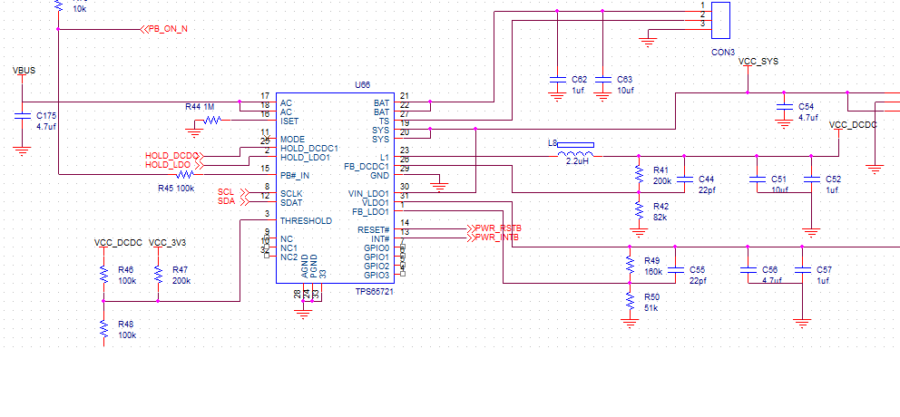

     So It`s concluded that the current dissipation is within tps65721, but it`s so large that we don`t know why. Our schematics is attached, basically follow your reference.

    Do you see any changes on BAT or SYS during your testing? Could they be drawing increased current?
    Do you see the same behavior when you remove R46?
    Does the current increase similarly when using i2c to force PWM instead of the MODE pin?

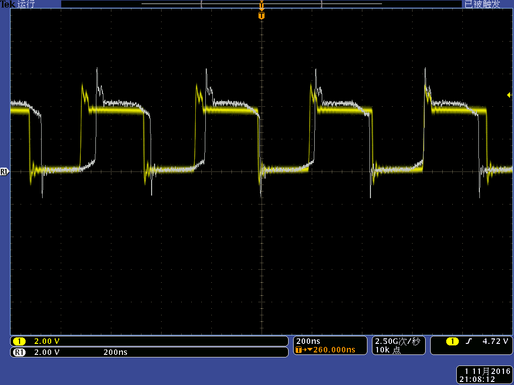

    Thanks. We located a board (different batch but using same schematics) with different result. The board shows 15mA delta on V_IN while switching from PFM to PWM
    We measure the voltage before the conductor (L8), though there seems no much difference. The yellow curve is from the boards with 120mA diff from PFM to PWM, the white curve is from the board with 15mA from PFM to PWM.

  • Hi Zonghua,
    I'm assuming both boards have identical voltage dividers for DCDC1, and same conditions such as input and output voltage, correct?
    If the two boards have seen different hours of operation it could be an indicator of electrical overstress, can you identify if the 15mA board starts to see an increase in current consumption over time? What feeds VCC_3V3 in this design and is it necessary that a path exists to DCDC1 via the threshold pin?
