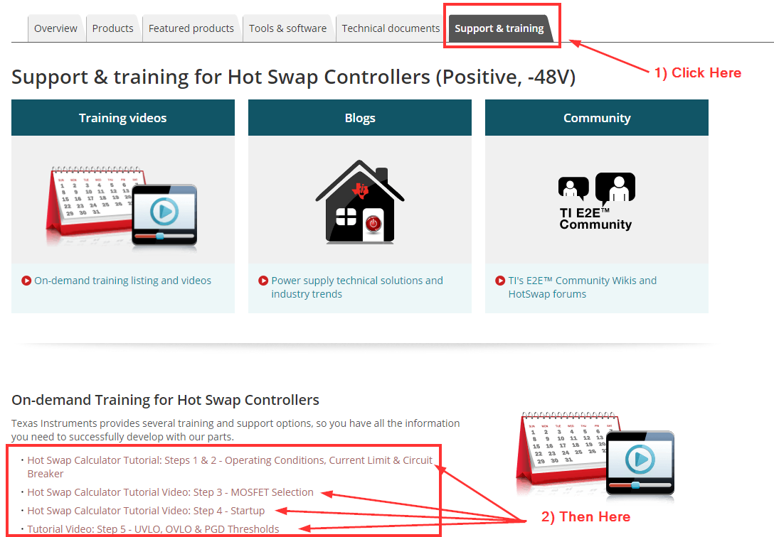

    Thanks for pointing these things out. The reason why we have cell F49 refer to F46 is because that's the cell one changes in order to set the value of the Actual PLIM Cell. Cell F44 is just the fixed minimum value. But I do see how that can be confusion.
    I do agree with you that F50 might be confusing without a comment. I'll talk to the team and see if we can change that. Also, since these design calculators have a lot going on to them, our team created step-by-step videos on how to fill out them out, cell by cell. The videos are broken into four segments: steps 1&2, step 3, step 4, and step 5. You can find these videos by going to www.ti.com/hotswap ==> click on "Support & Training" ==> Click on "Hot Swap Calculator Tutorial" (look below):
