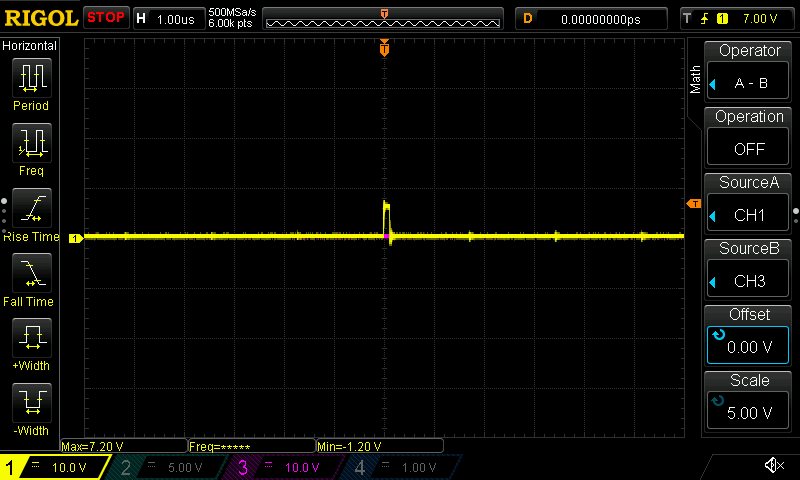

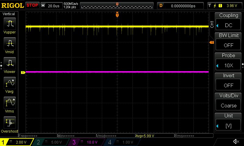

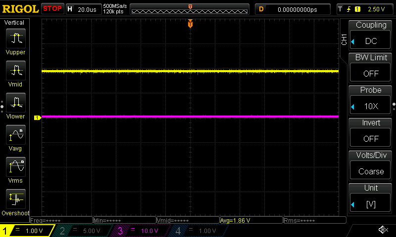

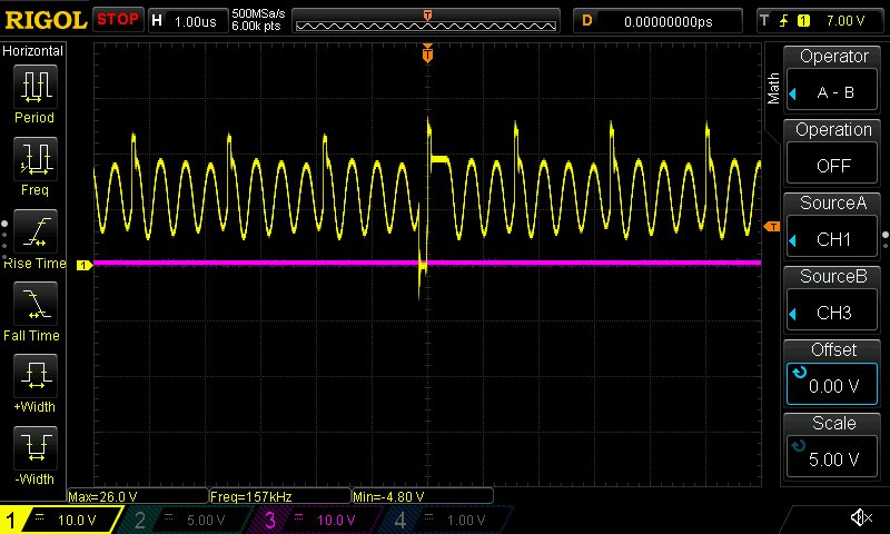

I am solving several field failures of a device using the BQ24650 that is already in production. Some of them have rather strange behaviour in the HIDRV and PH nodes. In this group of failures, the devices have all signals working correctly, with exception of HIDRV, PH  and MPPSET . Please see the following scope captures:
HIDRV pin reference to GND
Vph referenced to ground:

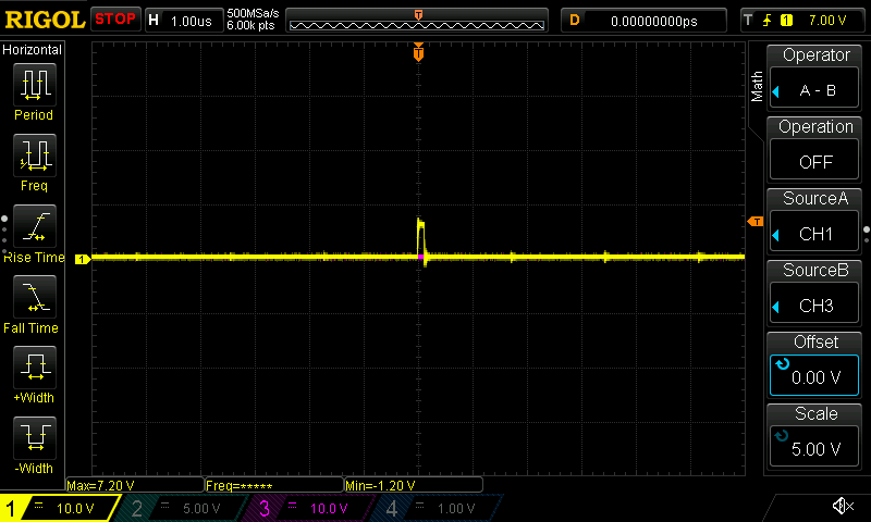

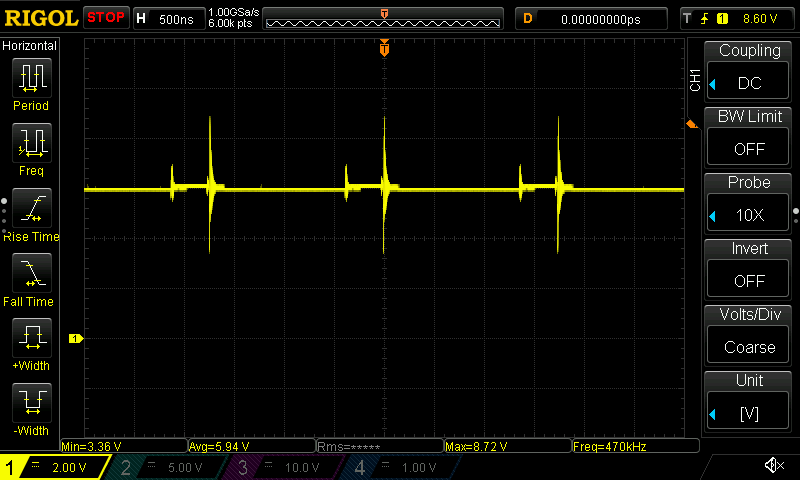

So this waveforms are not of normal operation of the device. I understand HIDRV is 6V higher than PH when enabling the High side mosfet. So here is a waveform of HIDRV referenced from PH, which is exactly Vgs of the high side mosfet, for reference:
What could be the cause of that strange waveform that 1) has that ringing and 2) is driving the high side mosfet for a very short time. I think this is the reason why MPPSET can not be correctly performed and is at 1.4V instead of 1.2V.

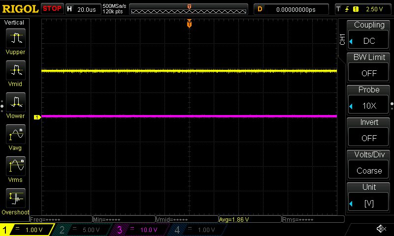

Vfb referenced to GND (sems OK)

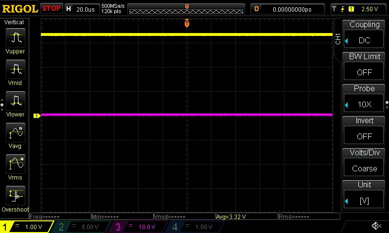

Vref referenced to GND ( ~3.3V, seems OK)

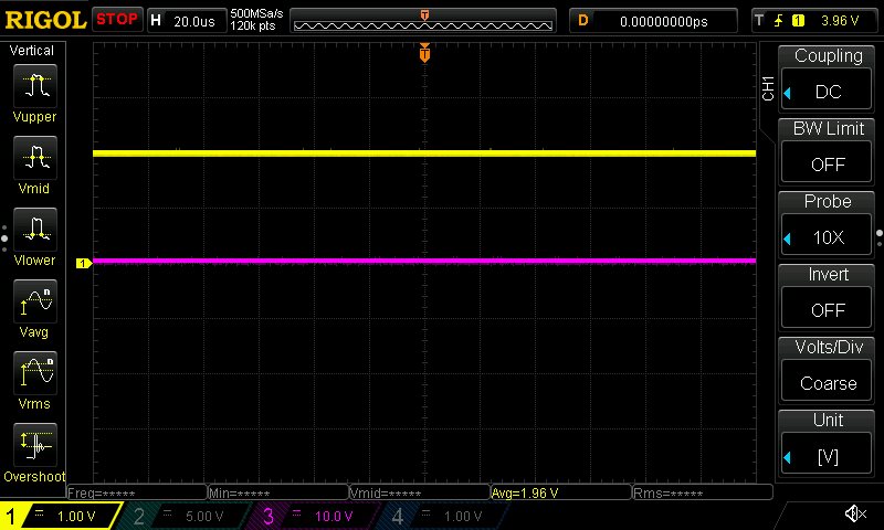

Vmppset referenced to GND (1.32V, sometimes 1.4V, not ok)

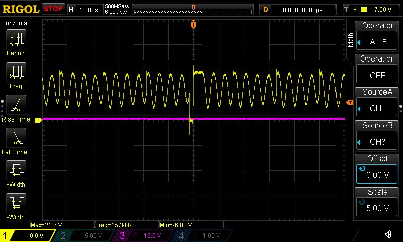

Vbtst referenced to Vph, (not OK, should be very stable at ~6V)

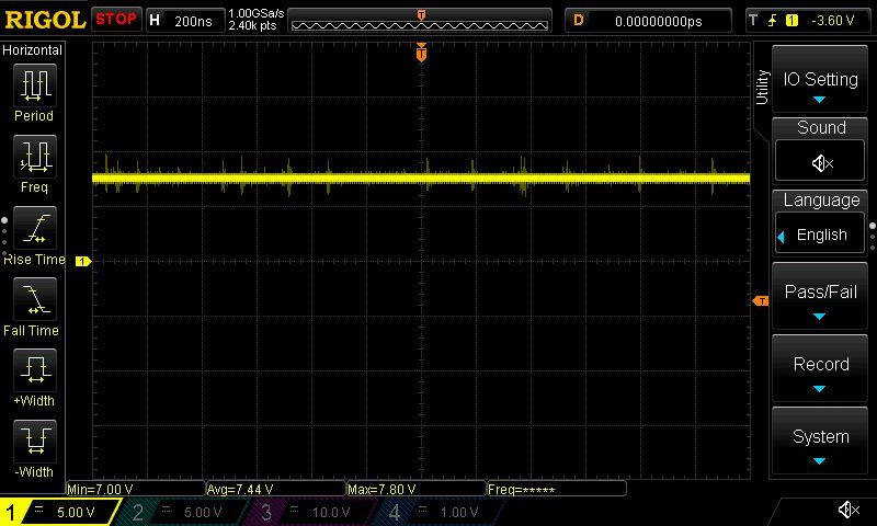

Vcc referenced to Vsrn: Vcc >> ( Vsrn + 100mV) , actually Vcc is aprox 7.44V above Vsrn so the device is definitely ON.

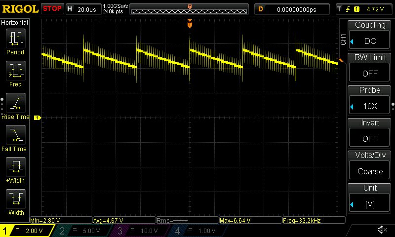

Vlodriv (does not look ok, just as hidrv, does not seem it is switching fast enough)

    From the waveforms, it looks like the converter is operating in DCM. Usually this is okay for a buck converter I think, but it may be causing you some grief here. BTST does seem a little "funky", though.

    It is okay that MPPSET is above 1.2V. If you look at the system diagram in the datasheet, you will see that the 1.2V reference is at the non-inverting terminal of the op-amp. This means that MPPSET can be above 1.2V, but if it tries to drop below it will maintain at 1.2V. Comparing this to the Vfb op-amp, you see that the Vfb amp reference voltage is at the inverting terminal. That is why the output voltage can be below Vreg in the CC phase, but will not go above Vreg.
