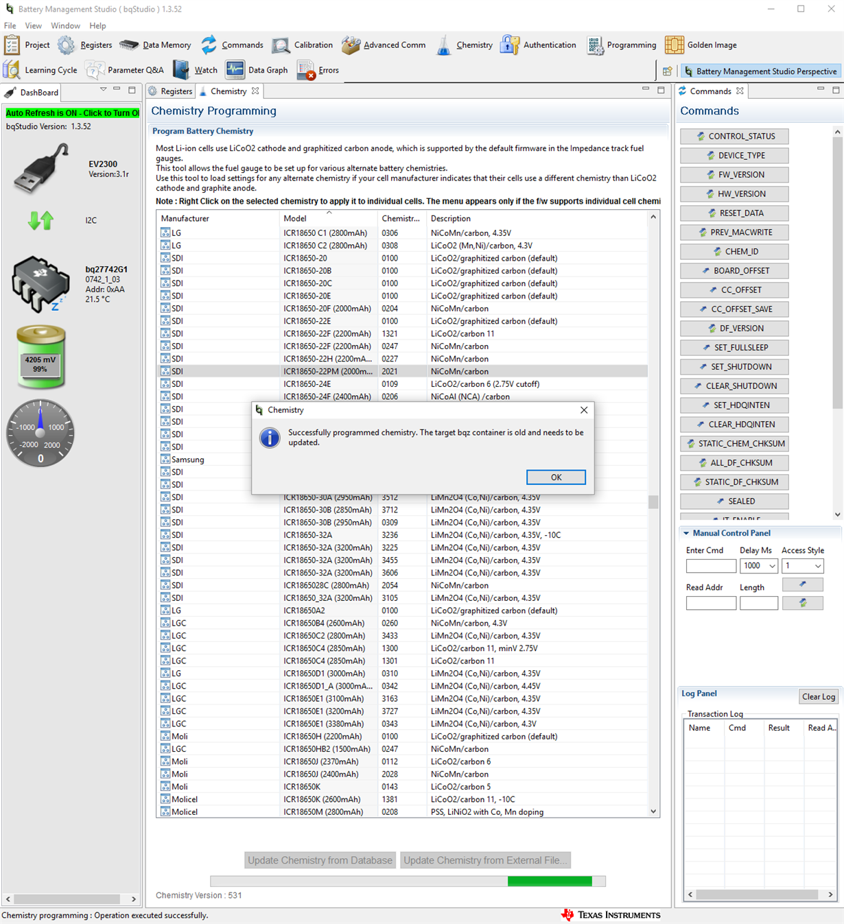

Recently I start a project using this BQ27742-G1. After updating the chemID I obtained the same warning,
a) Is this issue solved?
b) How can a fix this warning?

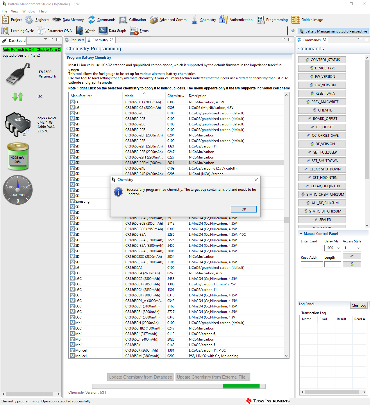

This is the image for the last message, I forgot to attached. I tried again using the new Chemistry version 531 but the result is the same. The bqStudio 1.3.52 seems to be the most recently version.
What do you suggest to do?
Is this issue going to generate wrong calculations on the fuel gauge?

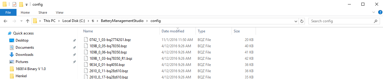

Hi Julio,
Please unzip and paste this file into C:\ti\BatteryManagementStudio\config
Try programming chemistry again and see if you see the same error.
