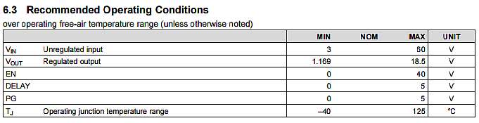

Would like to check on the EN voltage of TPS7A16.  The following is an extract from the datasheet.  The recommended range of VEN  is 0V - 40V.  Whereas VIN is up to 60V.
In the datasheet under section 5, it also stated that if EN pin is not used, it can be connected to IN.  So the questions is, will there be any issue if VIN is between 40V to 60V when EN pin is connected to it ?
