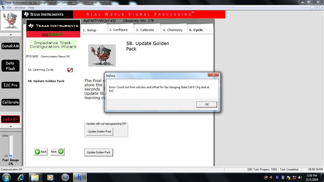

At the end of learning cycle, when I hit on the Create Golden image, the below error occurs. What can be the issue with below? Is the generated golden image is fine or it is not to be used?

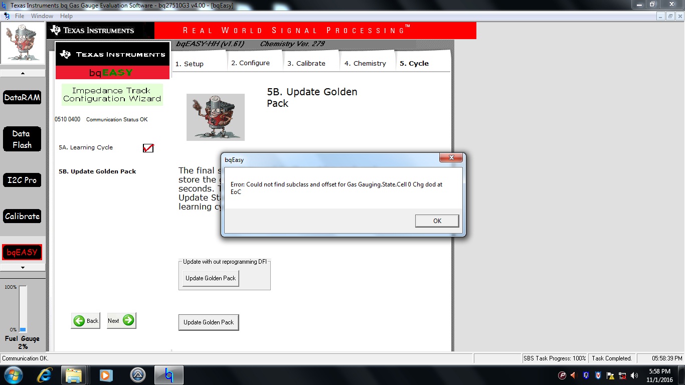

This looks like a bug with EVSW. Please use http://www.ti.com/tool/bqstudio to generate the golden image. You don't have to re-do anything (learning cycle, configuration); just launch bqStudio with the EVM attached and then click on the Golden Image button.
