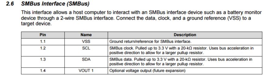

I have a EV2400 Evaluation Module and would like to modify one of the four pin connector cable to interface with a RJ45 cable.  I will utilize the SMBus port of the EV2400 to the RJ45 connector on a Micropower Ironworks SMART battery.  Could you please provide the pin out sequence to the RJ45 cable?
