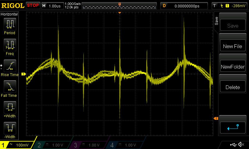

Greetings, I have an LM5175 design showing large, fast spikes in the output waveform. The design is required to accommodate a 10-15V  input, and provide a regulated 13.0V 10A (max) output. The switching frequency is set to 500KHz. With a 13.0V input and a 6.5A load, we see the following waveform:
Any suggestions concerning cause?

    The fast spikes may not have anything to do with the controller IC. This seems like the switching noise coupling to the probes.
    If you use short probe tips (GND and VOUT) close to the ceramic capacitorss the high frequency spikes should go away or decrease.
  • I have traced the larger spikes to ringing at the L1 MOSFET gate. The smaller spikes occur at every MOSFET state change. I concur that the controller is not a problem here.
