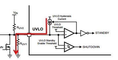

There is below equation on the (1) of the datasheet.
I can't understand why VHYS is calculated by RUV2.
I recognize IHYS(10uA) flows RUV1, so I think that VHYS must be calculated by RUV1.
Is my understanding wrong?
