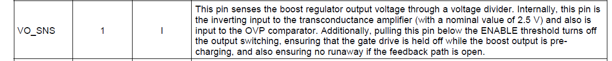

    1. I've looked at the reference, the FB signal is generated by the TL431 based compensation network and transmitted to the primary side through the optocoupler. Basically, the internal transconductance amplifier is bypassed. To get this function working, the Vo_sns pin has to be pulled below ENABLE as shown below.

    At the first, I thought the FB signal from the opto would discrete the switching PWM into discontinuous duration piece by piece, thus affect the line current away from sine wave (one reason of doing PFC). So that, I enable it (rather than tune the FB to about 2.5v*(301k+30.1k)/30.1k=27.5v, over the Vcc max rating) to about Vcc=16v. That's different from the reference.
    But I guess the sine wave current issue was solved by the heavy RC filter of driving opto+TL431.
