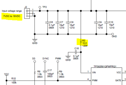

I have a customer who's designing with our TPS92691 LED Driver.  The supply goes from 12V to 60V.  The datasheet recommends "to bypass the VIN pin with a 0.1-µF ceramic capacitor placed as close as possible to the device and add a series 10-Ω resistor..."
How much current will this 10 ohm resistor carry?  The typical application uses a 1206 (1/4W) resistor for an 18V supply.  Will this current scale at all with supply voltage?
