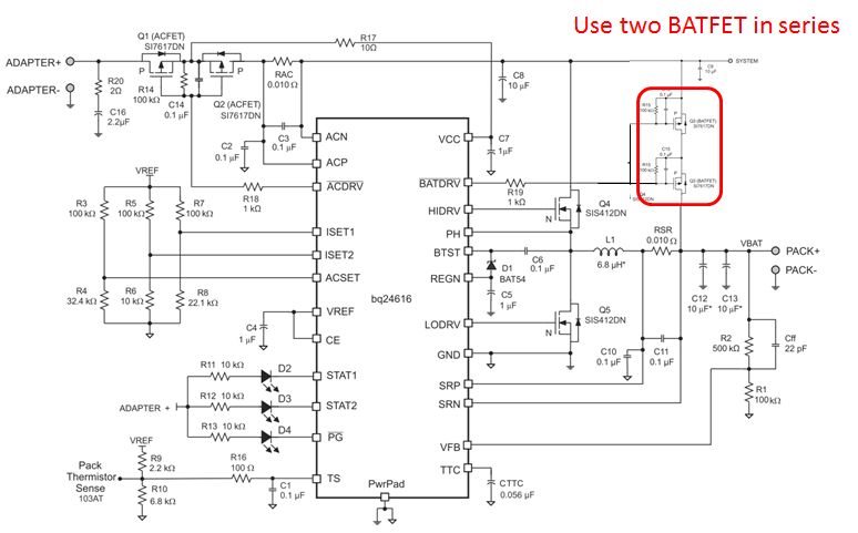

    I asked about parallel use in previous post, but my customer is asking to use in series, not parallel. They plan to use two FETs in series for fail safe if BATFET will be short fail. Then can you recommend to use two BATFET in series like attached?

  • Hi Sanoki,
    I understand, that is a valid concern on their part.
    In terms of the BATDRV capability, it should be okay. It will probably turn on a little slower, but that is not necessarily bad, since ACDRV and BATDRV should always have some deadtime in between. I do have  some comments/concerns:
    • There will be ~1.4V drop (and the corrosponding efficiency hit) in the time between battery supplementing the system and the  BATFETS turning on. Can their system  handle that voltage drop without crashing?
    • When the BATFET is off, the gate, source, and  drain node will all be equal to ACN (no current  is  flowing, so the source of the bottom FET will be pulled to gate). I am not  sure how the top FET will handle this, but my guess is that there is a chance  it  results in a failed FET.
    • I am also concerned that  when BATDRV is ACN-6, the top FET will not  turn on all the way, resulting in efficiency loss/voltage drop. This may be acceptable, but  something  to think about.
    In general, I would say  that if you have a board you can  test with you can certainly try, it shouldn't be catastrophic if it  fails. I don't have much confidence in this arrangement working, though. Maybe it is  possible  to use the BATDRV signal as a "logic" signal that triggers an external gate drive for the second FET, or a similar  arrangement.
